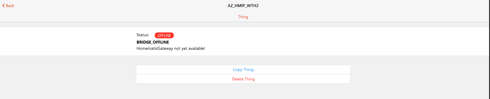

I was maybe not precise enough. With “offline”, I really mean your first option where I see the red offline label in the UI, so, the status of the thing.
But I definitely have no code tab. See example screenshot:
I just see that the bridge thing itself does have the code tab.
(sorry, this forum does not allow me as “new user” to add more than one image in one post :person_shrugging:)
But not the depending thing.
