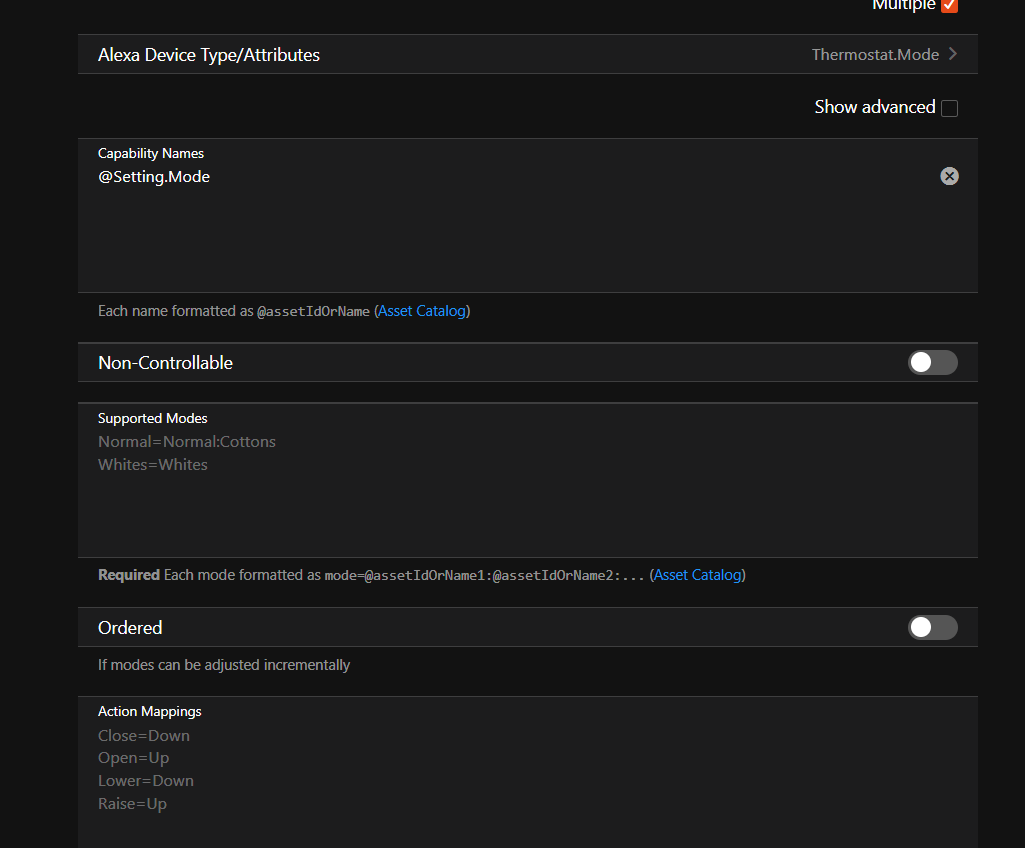

My issue now is that I am not sure how I need to tag my proxy item in the Alexa Metadata UI, so all the different Modes are usable in Alexa.
I thought about using Thermostat.Mode but I am unsure if that is correct and I am unsure what exactly to enter in Supported Modes and what exactly in Action Mappings.
Any tips what to set to make it work with Alexa?

I have added these in the supported mode field now and alexa is now recognizing the modes.
Automatic=Automatic
Comfort=Comfort
Boost=Boost
But when I am in the alexa app and click on the Thermostat, then there is no dropdown of modes available. What do I need to do so they show up there aswell ?
That’s the issue with using the generic attribute over the specific one. Granted that the latter one is more rigid, it is integrated in the Alexa app thermostat implementation while the former isn’t.
So you will have to decide what’s more important to you. If you decide to use HeatingCoolingMode, then you will have to pick the closest supported mode that matches your setup.
