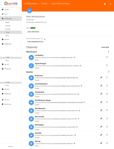

HomeMatic Weather Station HM-WDS100-C6-O-2
It seems that some data points (rain today, rain yesterday) of this thing are stored in system variables and are not visible in Thing’s Channels generated through PaperUI.
Would it be possible to be insourced as a standard channel, or does anybody know how to access this value and get the actual value without refreshing over GatewayExtras.

Any news on this topic? I’d also like to get the rain today and rain yesterday in openHab.
I would suggest you google about MQTT and HomeMatic. It is possible to send mqtt messages from homematic. so setup a program which sends the value over mqtt over to openhab.
I implemented following ignoring the path of getting the values from HomeMatic:
