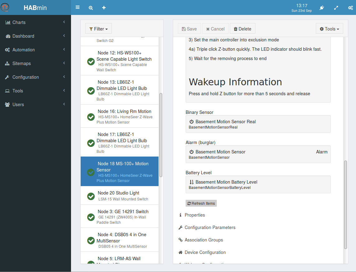

I have multiple HS-MS110+ motion sensors that appear to have different behavior. On top of that, the assignment of the events appears to be mixed up, with the motion sensing event coming through the burglary alarm event, which is intended to alert whenever the motion sensor is experiencing physical movement.
One motion sensor succeeds in firing a motion event;

Another one does not;

In the first one, event=8. In the second, event=0. It’s not clear to me how I can solve this.
Is is best to fix the misassignment of events first? If so, what is the process?

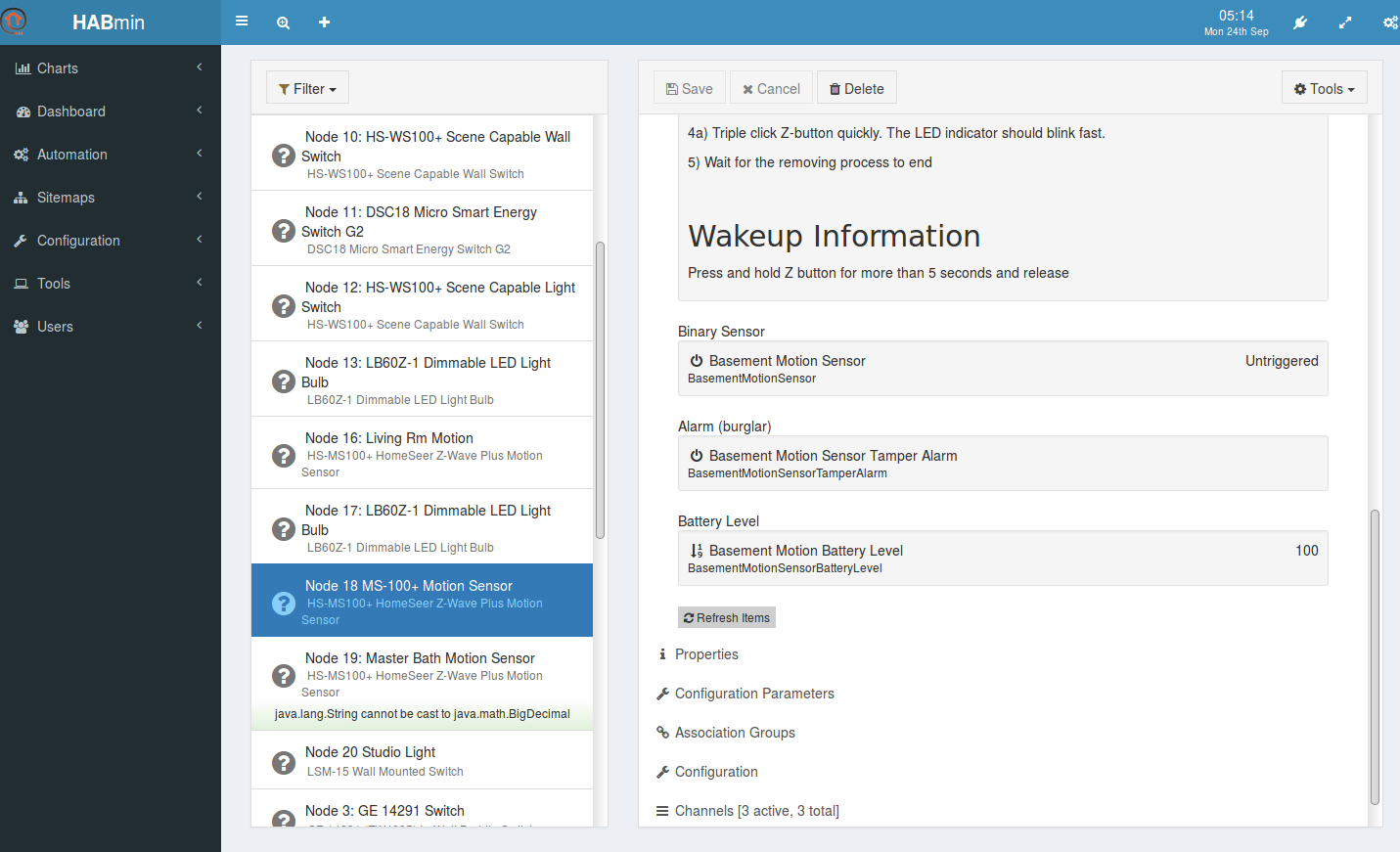

However, no Z-Wave events are being generated and all of the Z-Wave things in HABmin have question marks beside them, as shown below;
QuestionMarksOnZWaveThings
Are more restarts required or some other approach?
Did you delete all things and reinstall them? This is required to get the updated definitions - see the following thread -:
Ok, have completed this process, am back to normal with all other sensors and effectors, and yet am still having issues with all of the MS11+ motion sensors generating events (not just one or two). They do generate reports, though those are not turning into events;

And for some reason, the Zooz 4 in 1 tamper alarm may be in a similar situation. While it does not seem to be showing up explicitly after I pick it up and move it around, I do receive multiple alarms in short succession (the latter of which is timed to when I actually picked it up), which it is not configured to do, as trigger interval is set to 60 seconds;
2018-09-29 09:53:29.525 [DEBUG] [nal.protocol.ZWaveTransactionManager] - NODE 2: Application Command Request (ALIVE:DONE)
2018-09-29 09:53:29.525 [DEBUG] [ng.zwave.internal.protocol.ZWaveNode] - NODE 2: resetResendCount initComplete=true isDead=false
2018-09-29 09:53:29.525 [DEBUG] [ng.zwave.internal.protocol.ZWaveNode] - NODE 2: Incoming command class COMMAND_CLASS_ALARM, endpoint 0
2018-09-29 09:53:29.525 [DEBUG] [ng.zwave.internal.protocol.ZWaveNode] - NODE 2: SECURITY not supported
2018-09-29 09:53:29.525 [DEBUG] [tocol.commandclass.ZWaveCommandClass] - NODE 2: Received COMMAND_CLASS_ALARM V4 NOTIFICATION_REPORT
2018-09-29 09:53:29.525 [DEBUG] [.commandclass.ZWaveAlarmCommandClass] - NODE 2: NOTIFICATION report - 7 = 255, event=8, status=255, plen=0
2018-09-29 09:53:29.525 [DEBUG] [.commandclass.ZWaveAlarmCommandClass] - NODE 2: Alarm Type = BURGLAR (7)
2018-09-29 09:53:29.526 [DEBUG] [ding.zwave.handler.ZWaveThingHandler] - NODE 2: Got an event from Z-Wave network: ZWaveAlarmValueEvent
2018-09-29 09:53:29.526 [DEBUG] [ding.zwave.handler.ZWaveThingHandler] - NODE 2: Got a value event from Z-Wave network, endpoint = 0, command class = COMMAND_CLASS_ALARM, value = 255
2018-09-29 09:53:29.526 [DEBUG] [ternal.converter.ZWaveAlarmConverter] - NODE 2: Alarm converter processing NOTIFICATION
2018-09-29 09:53:29.526 [DEBUG] [ternal.converter.ZWaveAlarmConverter] - NODE 2: Alarm converter NOTIFICATION event is 8, type OnOffType
2018-09-29 09:53:29.526 [DEBUG] [ding.zwave.handler.ZWaveThingHandler] - NODE 2: Updating channel state zwave:device:1645796be4b:node2:alarm_motion to ON [OnOffType]
2018-09-29 09:53:29.527 [DEBUG] [ternal.converter.ZWaveAlarmConverter] - NODE 2: Alarm converter processing NOTIFICATION
2018-09-29 09:53:29.527 [DEBUG] [ternal.converter.ZWaveAlarmConverter] - NODE 2: Alarm converter NOTIFICATION event is 8, type OnOffType
2018-09-29 09:53:29.527 [DEBUG] [nal.protocol.ZWaveTransactionManager] - NODE 2: Commands processed 1.
2018-09-29 09:53:29.527 [DEBUG] [nal.protocol.ZWaveTransactionManager] - NODE 2: Checking command org.openhab.binding.zwave.internal.protocol.ZWaveCommandClassPayload@4cd93486.
2018-09-29 09:53:29.527 [DEBUG] [nal.protocol.ZWaveTransactionManager] - Transaction completed - outstandingTransactions 0
2018-09-29 09:53:38.448 [DEBUG] [nal.protocol.ZWaveTransactionManager] - NODE 2: Application Command Request (ALIVE:DONE)
2018-09-29 09:53:38.448 [DEBUG] [ng.zwave.internal.protocol.ZWaveNode] - NODE 2: resetResendCount initComplete=true isDead=false
2018-09-29 09:53:38.449 [DEBUG] [ng.zwave.internal.protocol.ZWaveNode] - NODE 2: Incoming command class COMMAND_CLASS_ALARM, endpoint 0
2018-09-29 09:53:38.449 [DEBUG] [ng.zwave.internal.protocol.ZWaveNode] - NODE 2: SECURITY not supported
2018-09-29 09:53:38.449 [DEBUG] [tocol.commandclass.ZWaveCommandClass] - NODE 2: Received COMMAND_CLASS_ALARM V4 NOTIFICATION_REPORT
2018-09-29 09:53:38.449 [DEBUG] [.commandclass.ZWaveAlarmCommandClass] - NODE 2: NOTIFICATION report - 7 = 255, event=8, status=255, plen=0
2018-09-29 09:53:38.449 [DEBUG] [.commandclass.ZWaveAlarmCommandClass] - NODE 2: Alarm Type = BURGLAR (7)
2018-09-29 09:53:38.449 [DEBUG] [ding.zwave.handler.ZWaveThingHandler] - NODE 2: Got an event from Z-Wave network: ZWaveAlarmValueEvent
2018-09-29 09:53:38.449 [DEBUG] [ding.zwave.handler.ZWaveThingHandler] - NODE 2: Got a value event from Z-Wave network, endpoint = 0, command class = COMMAND_CLASS_ALARM, value = 255
2018-09-29 09:53:38.449 [DEBUG] [ternal.converter.ZWaveAlarmConverter] - NODE 2: Alarm converter processing NOTIFICATION
2018-09-29 09:53:38.449 [DEBUG] [ternal.converter.ZWaveAlarmConverter] - NODE 2: Alarm converter NOTIFICATION event is 8, type OnOffType
2018-09-29 09:53:38.449 [DEBUG] [ding.zwave.handler.ZWaveThingHandler] - NODE 2: Updating channel state zwave:device:1645796be4b:node2:alarm_motion to ON [OnOffType]
2018-09-29 09:53:38.450 [DEBUG] [ternal.converter.ZWaveAlarmConverter] - NODE 2: Alarm converter processing NOTIFICATION
2018-09-29 09:53:38.450 [DEBUG] [ternal.converter.ZWaveAlarmConverter] - NODE 2: Alarm converter NOTIFICATION event is 8, type OnOffType
2018-09-29 09:53:38.450 [DEBUG] [nal.protocol.ZWaveTransactionManager] - NODE 2: Commands processed 1.
2018-09-29 09:53:38.450 [DEBUG] [nal.protocol.ZWaveTransactionManager] - NODE 2: Checking command org.openhab.binding.zwave.internal.protocol.ZWaveCommandClassPayload@6a3e0c8b.
2018-09-29 09:53:38.450 [DEBUG] [nal.protocol.ZWaveTransactionManager] - Transaction completed - outstandingTransactions 0
2018-09-29 09:53:47.752 [DEBUG] [nal.protocol.ZWaveTransactionManager] - NODE 2: Application Command Request (ALIVE:DONE)
2018-09-29 09:53:47.752 [DEBUG] [ng.zwave.internal.protocol.ZWaveNode] - NODE 2: resetResendCount initComplete=true isDead=false
2018-09-29 09:53:47.752 [DEBUG] [ng.zwave.internal.protocol.ZWaveNode] - NODE 2: Incoming command class COMMAND_CLASS_ALARM, endpoint 0
2018-09-29 09:53:47.752 [DEBUG] [ng.zwave.internal.protocol.ZWaveNode] - NODE 2: SECURITY not supported
2018-09-29 09:53:47.752 [DEBUG] [tocol.commandclass.ZWaveCommandClass] - NODE 2: Received COMMAND_CLASS_ALARM V4 NOTIFICATION_REPORT
2018-09-29 09:53:47.752 [DEBUG] [.commandclass.ZWaveAlarmCommandClass] - NODE 2: NOTIFICATION report - 7 = 255, event=8, status=255, plen=0
2018-09-29 09:53:47.752 [DEBUG] [.commandclass.ZWaveAlarmCommandClass] - NODE 2: Alarm Type = BURGLAR (7)
2018-09-29 09:53:47.752 [DEBUG] [ding.zwave.handler.ZWaveThingHandler] - NODE 2: Got an event from Z-Wave network: ZWaveAlarmValueEvent
2018-09-29 09:53:47.753 [DEBUG] [ding.zwave.handler.ZWaveThingHandler] - NODE 2: Got a value event from Z-Wave network, endpoint = 0, command class = COMMAND_CLASS_ALARM, value = 255
2018-09-29 09:53:47.753 [DEBUG] [ternal.converter.ZWaveAlarmConverter] - NODE 2: Alarm converter processing NOTIFICATION
2018-09-29 09:53:47.753 [DEBUG] [ternal.converter.ZWaveAlarmConverter] - NODE 2: Alarm converter NOTIFICATION event is 8, type OnOffType
2018-09-29 09:53:47.753 [DEBUG] [ding.zwave.handler.ZWaveThingHandler] - NODE 2: Updating channel state zwave:device:1645796be4b:node2:alarm_motion to ON [OnOffType]
2018-09-29 09:53:47.754 [DEBUG] [ternal.converter.ZWaveAlarmConverter] - NODE 2: Alarm converter processing NOTIFICATION
2018-09-29 09:53:47.754 [DEBUG] [ternal.converter.ZWaveAlarmConverter] - NODE 2: Alarm converter NOTIFICATION event is 8, type OnOffType
2018-09-29 09:53:47.754 [DEBUG] [nal.protocol.ZWaveTransactionManager] - NODE 2: Commands processed 1.
2018-09-29 09:53:47.754 [DEBUG] [nal.protocol.ZWaveTransactionManager] - NODE 2: Checking command org.openhab.binding.zwave.internal.protocol.ZWaveCommandClassPayload@2cf36b11.
2018-09-29 09:53:47.754 [DEBUG] [nal.protocol.ZWaveTransactionManager] - Transaction completed - outstandingTransactions 0
Unless I missed one, they are all the same event 8, which is motion alarm.
I will update the MS-100 tamper alarm as well - thanks.
Ok, I believe the multiple motion alarm reports are due to the fact that I associate the Node 2 Zooz with light nodes 17 and 20, both of which acknowledge they receive and act on the commands. Wife is dragging me out the door physically now, so…
It shouldn’t cause this as those commands will go directly to the respective devices. However, what will cause it is if you have the binding in more than 1 association group.
I’ve updated the binding and once the CI checks are complete I’ll merge and kick off a build, so you should be able to update once your wife allows you to return :wink:
Note that the channel changed to alarm_motion, and I’ve also added alarm_tamper. You will need to delete this thing, and add it back again so that the binding gets the updated thing configuration (don’t exclude the device - just delete/add).
https://github.com/openhab/org.openhab.binding.zwave/pull/1020
