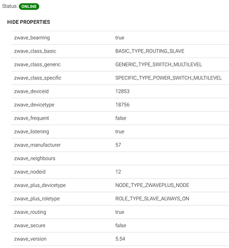

I’m running 2.5.9-1 and tried to set up a new z-wave network today. All of my on / off switches worked fine, but my dimmers all showed up unknown:
2020-10-01 12:08:37.992 [WARN ] [wave.discovery.ZWaveDiscoveryService] - NODE 9: Device discovery could not resolve to a thingType! 0039:4944:3235::5.54
I tried to re-initialize them without any luck, and found them in the database here:
https://opensmarthouse.org/zwavedatabase/1213
but perhaps these “newer” models are on older firmware? They were just purchased from Amazon, and all of them were not recognized. The on / off switches all showed up fine.
Any help would be appreciated!
The database entry does not restrict by firmware version. Occasionally I have had success deleting the Thing from OH (do NOT exclude from the network) and then rediscovering.
Well, a reboot ended up fixing this for some reason. Very odd that they didn’t pick up the first time around, but all have been identified after a reboot.
Thanks for the tip, I’ve seen that before but didn’t get a chance to try it before the reboot.
