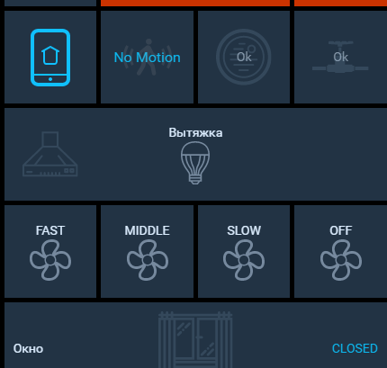

Everything works great in Habpanel! All switches and statuses from physical buttons are visible.

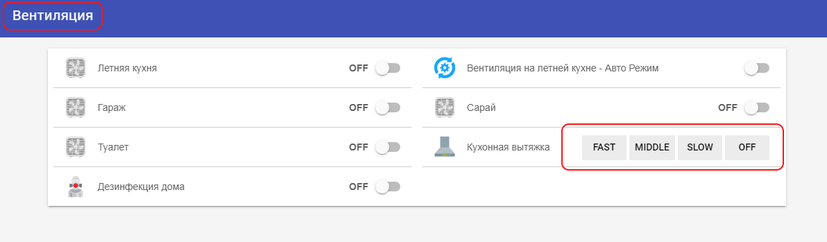

And here’s what comes out in basicui.
Buttons (mappings) are displayed normally (Switch relays).
But they do not display or toggle the status of physical buttons.
And they do not save the status when the browser page is refreshed.

Switch  item=GF_Kitchen_fan label="Кухонная вытяжка" mappings=[FAST="FAST", MIDDLE="MIDDLE", SLOW="SLOW", OFF="OFF"] icon="oiuyt"

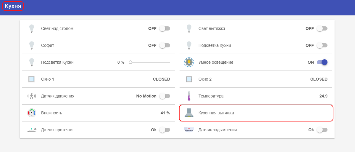

There are no buttons at all in the group.

Check in other browsers.
However …
unless you are hiding stuff from us, that will break autoupdate for this Item.
Meaning that its state will not change in response to commands.
Sitemap button highlighting is derived from Item state.
What group? You mean,if you use a Group widget in your sitemap?
Yes, that’s entirely expected. When you display a set of Items with a Group widget, each one is displayed with a default widget. There is no way to customize any of them for buttons, colour, etc.or even change the order.
If you need something like that, build the sitemap by hand instead using Text { } widget instead of Group widget.
