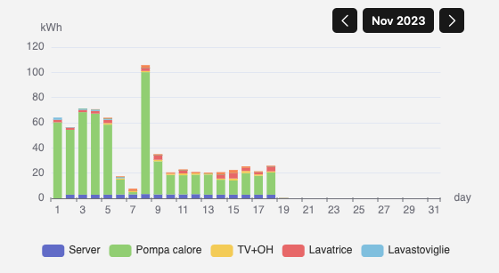

Hi all,

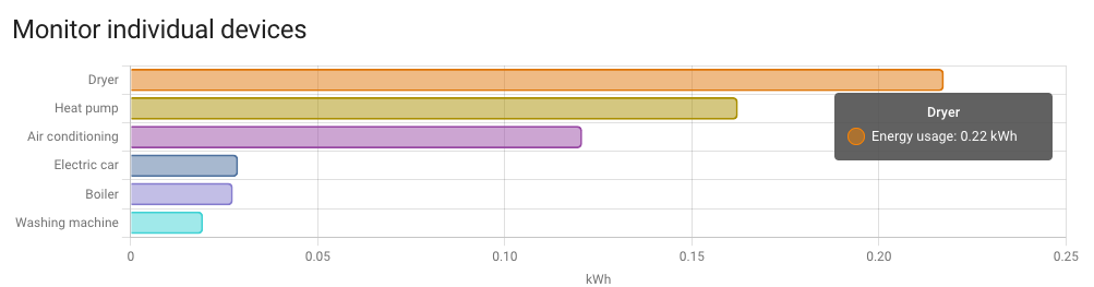

i am currently working on a widget to show energy expenditure by different appliances. Currently I managed to do a stacked bar chart, which is nice, but I would rather have a horizontal bar chart. Please see attached the current screenshot. What I would like to achieve is similar to the Home Assistant bar chart (screenshot 2).
Anyone knows how to get to that result?
Thank you very much!
Here is the code 'til now:

Screenshot actual state:

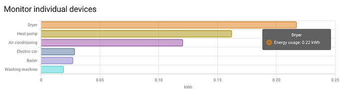

Screenshot of what I would like to achieve:

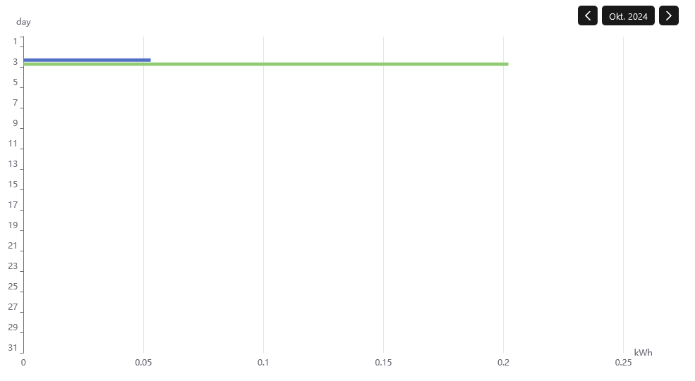

I think it is possible.
In this example yAxis and xAxis are changed.
Something like this is possible:
But we do not want to have every day of a month, but a sum of all days.
This is the current definition of the yAxis
  yAxis:
    - component: oh-category-axis
        gridIndex: 0
        categoryType: month
        monthFormat: short
        weekdayFormat: short
We need something like a categoryType: label
Checking the manual this seems not to be available.
Does anybody have an idea how to workaround it?
