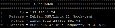

How can I change the Hostname reported in FireMotD? It does not match the actual Hostname. 20 was in the openhabian.conf during build but has since been updated using the config tool.
Thank you.
Thank you.
edit ~/.firemotd-cache
That worked after rebooting. Thank you.
