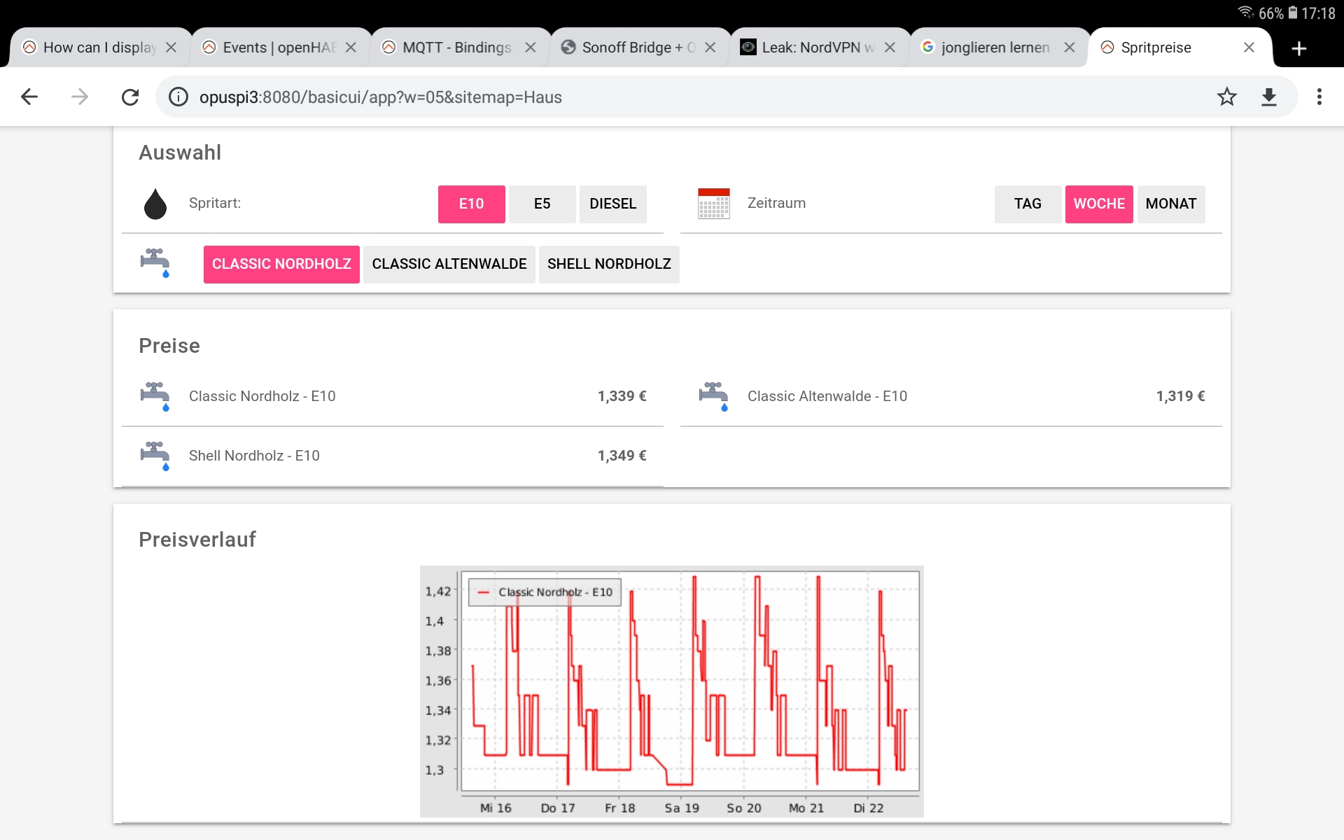

Consider to show more then one item in a chart or use the visibility flag in order to display only the needed one.
See this example from my sitemap:

I’m aware of the options to have several graphs in one chart, and also of the option to switch charts. But the basic idea is to have the whole house at a glance so that I can better understand which radiator has which effect):
