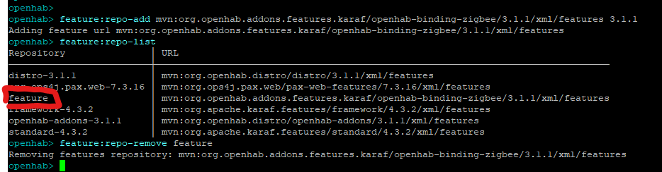

So I’ve tried to to things like:
feature:repo-add mvn:org.openhab.addons.features.karaf/openhab-binding-zigbee/3.1.1/xml/features 3.1.1
Here my first question, can I add here a name for the repo because currently only “feature” is displayed.
