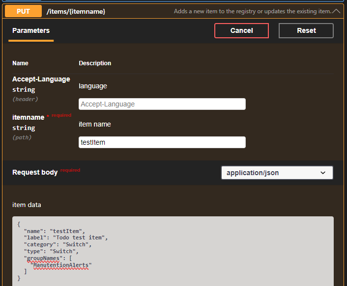

What works?
When I use swagger and test the API it works:
It creates the Item properly and return a 201 and I can see the item created.

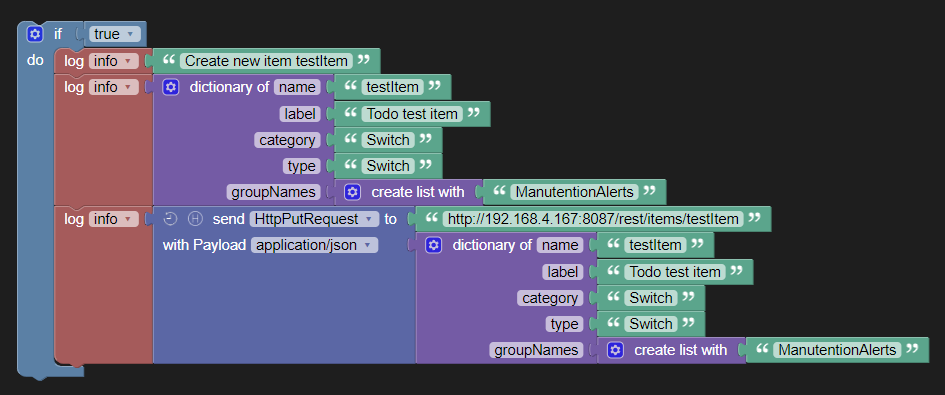

The problem is when I try to do that through blockly:
It generates some error logs:

Look very similar to the generated code of blockly:
if (true) {
  console.info('Create new item testItem');
  console.info({'name': 'testItem', 'label': 'Todo test item', 'category': 'Switch', 'type': 'Switch', 'groupNames': ['ManutentionAlerts']});
  console.info((actions.HTTP.sendHttpPutRequest('http://192.168.4.167:8087/rest/items/testItem',' application/json', {'name': 'testItem', 'label': 'Todo test item', 'category': 'Switch', 'type': 'Switch', 'groupNames': ['ManutentionAlerts']}, {'Accept': '*/*', 'Authorization': 'Bearer oh.OPENHABAPITOKEN.xzy'}, 3000)));
Which version of openhab are you using @Oliver2 ? might be the cause I guess?
EDIT:
seems that blockly add an extra space for the payload ???
' application/json'

Not sure if this makes a difference but delete the space character.
I am on 4.3.0
same issue unfortunately, might be something fixed in 4.3 is it “safe” to upgrade ? :slight_smile:

  1. The HTTP calls are natively provided by OH in blockly and do not work in 4.2 apparently.
That’s probably a bug to address and not to ignore with “other solution”. (I mean we should tackle that :slight_smile: not put it under the carpet. And it might be an opportunity for me to publish a bugfix I’m willing to help on this)
I will try to upgrade OH and see if it fix the problem.
If yes then it has been fixed in the new versions fair enough.
EDIT: I confirm, 4.3.0-M2 release do not have the issue anymore:
