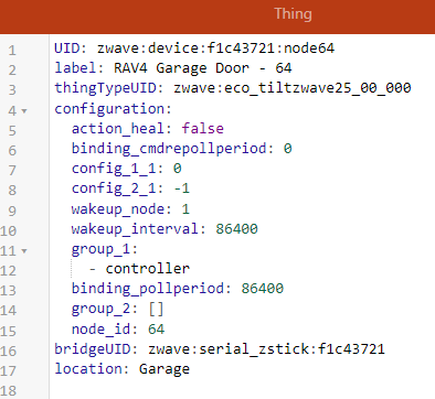

That’s one of the things that is not supported in .things files. You’ll have to do this through a managed Thing (i.e. accepted from the Inbox in MainUI). Then there will be an options to set the configuration parameters like that in the Things’s settings.
I don’t know the answer to that and suspect the answer depends on the binding. Given what little I know about the Zwave binding I’d expect you’d have to delete the file based Thing first. I doubt it can handle two Things pointing at the same device since the node ID would be the same and I think the node ID is how the binding uniquely identifies the device. Having it defined in both places will probably result in one taking precedence or something throwing an error.
In general it’s not a good idea to mix text based and file based like that.
I doubt having two Z-Wave things for the same physical device will work as the thing is related to the Z-Wave nodeID - it is likely things will get messed up (if it is even possible to save this.)
