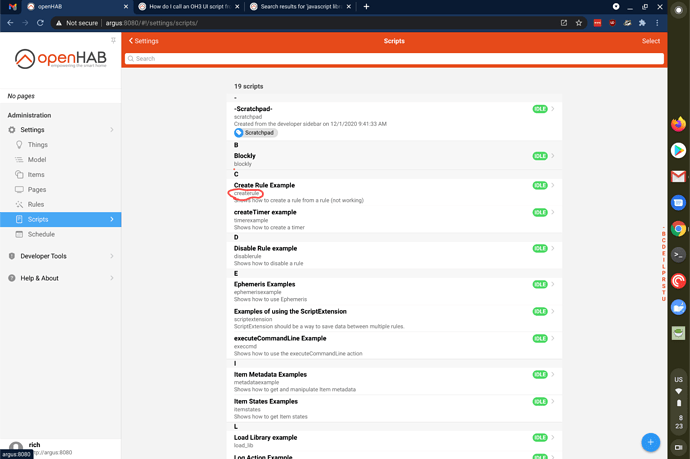

I’ve circled the UID of the Create Rule Example in the screen shot above. That’s the ID you need to use.

Ah, but a Script is a Rule. It’s just a special type of rule that only as a single Script Action and no triggers or conditions. And really the only difference is a Script has the Script tag.

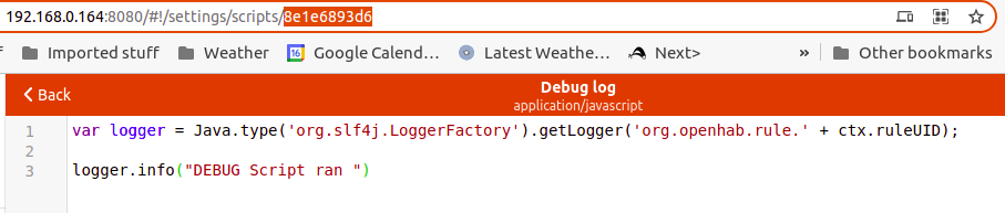

Here is how I do it.
This is in the scripts

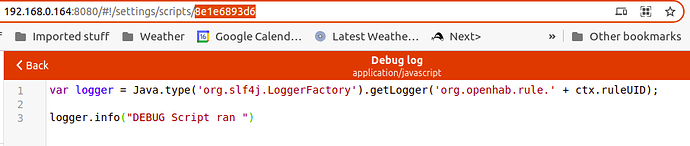

The id is 8e1e6893d6 so to copy and paste it I just click on the script to open it.
If you look in the url bar of your browser you will see the url link. I just click twice on the id and it highlights just that part of the url and then I just ctrl-c and ctrl-v to paste it where ever I want.
You can do the same to copy and paste item names.
Enjoy.
