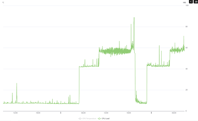

Hi I am running the latest 3.4.4 release on a RPI 4. In the last few weeks I’ve been getting a crash every few days. I can’t seem to find what is causing this. I did a fresh install on a new SD card to make sure it was not a corrupted card. I have the System Info binding running which shows that CPU jumps upto 40% then a bit later up to 60% and if I leave it eventually Openhab justs stops working.

cpu load openhab
