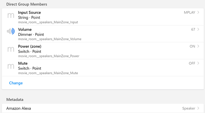

More interestd in the other direction. Creating a openhab item that can be controlled by other plugins. Not sure if this is a switch that is not connected to any channel and connected to LIRC via a rule. I guess there are a couple was to go. The switches for power and mute are probably pretty easy. Doing a string input selector that has a list of allowed values is harder. Also doing a volume slider without feedback of what the current volume is will also be a challenge.
I have a newer receiver that supports denonmarantz in another room that I control from alexa and I would like a similar experience with this older receiver and LIRC. Here is what the newer receiver looks like.
