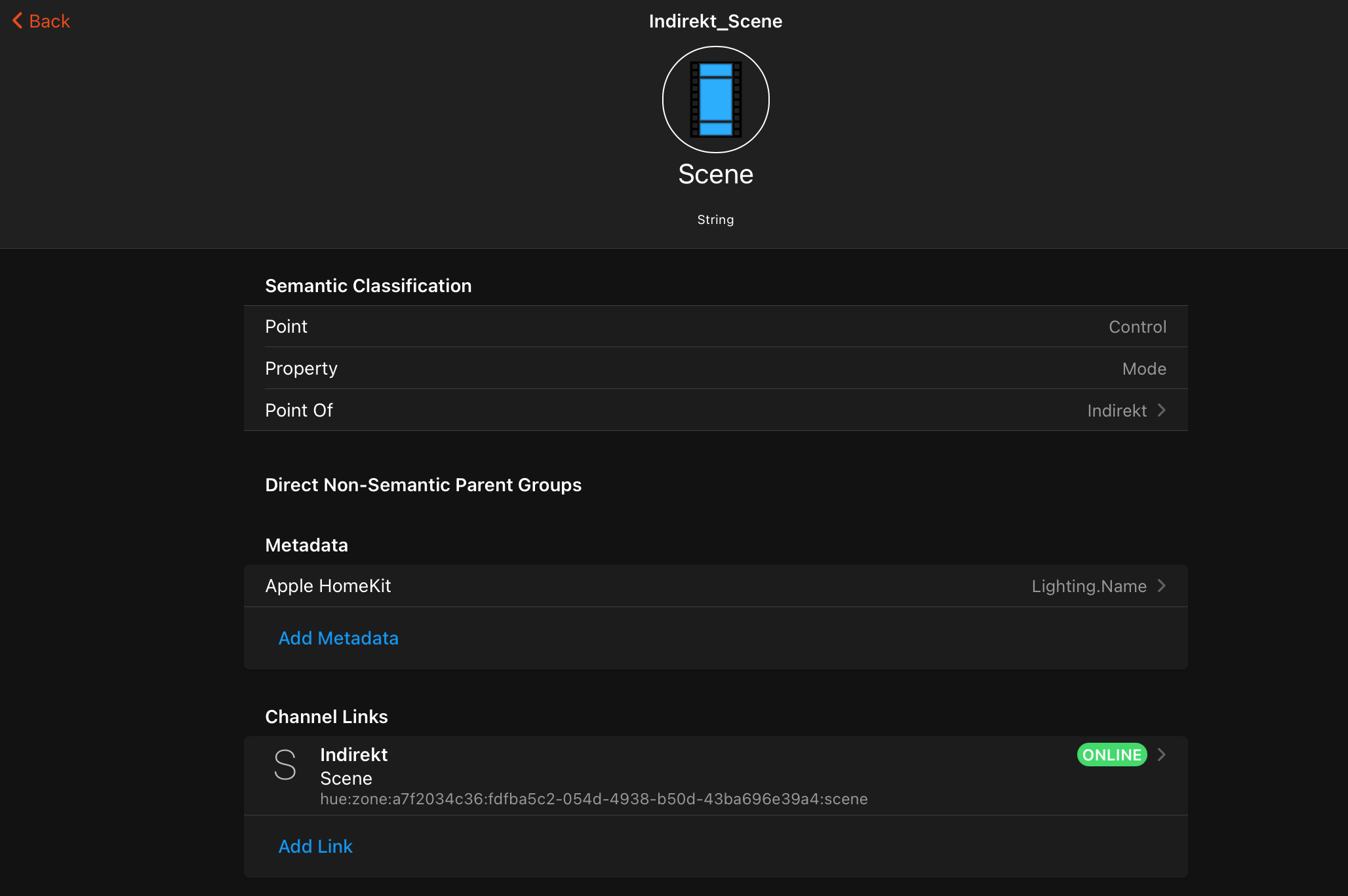

How do I get scenes in Homekit?
if someone knows a way to integrate the scenes from OH (see below) into the Homekit App?
I tried all possible Metadata without success.
Any help would be highly appreciated.
THX
So that’s an Item called “Scene” but it is not an openHAB Scene: see Rules | openHAB.
I don’t use HomeKit but looking at the list of supported accessory types (see HomeKit Add-on - System Integrations | openHAB) I don’t see anything that would correspond with the concept of a scene.
So I think you’re best bet is to create Switch Items with the names of the scenes and using then Switchable accessory type on those. You can use those to trigger a rule to command this Item as appropriate.
