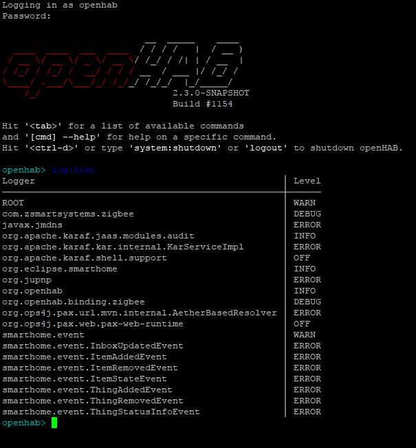

Benjy
(Ben Clark)
December 30, 2017, 7:52pm
12
You can use openHAB’s console and the command log:list to look at the currently set logging levels:
Does this help at all? I agree there should be some sort of list defined somewhere for specifics, but this list might be huge.
