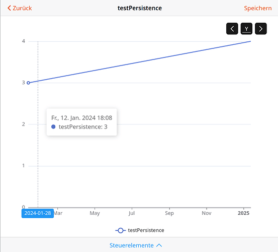

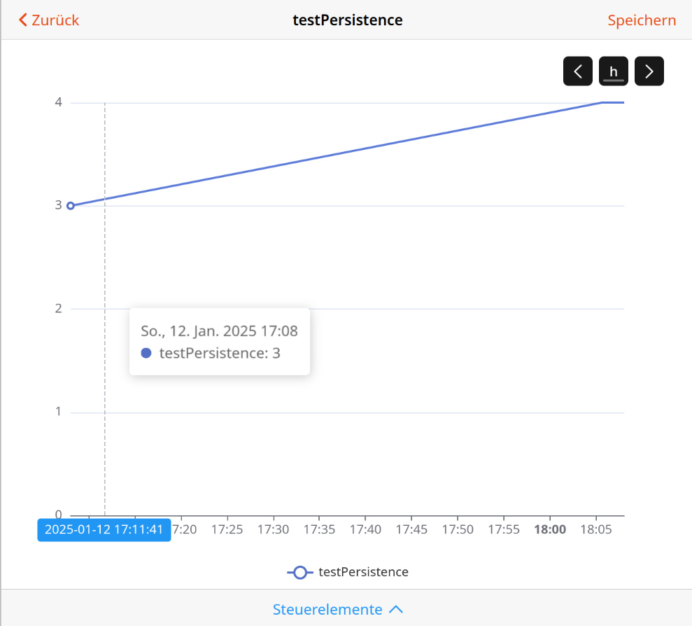

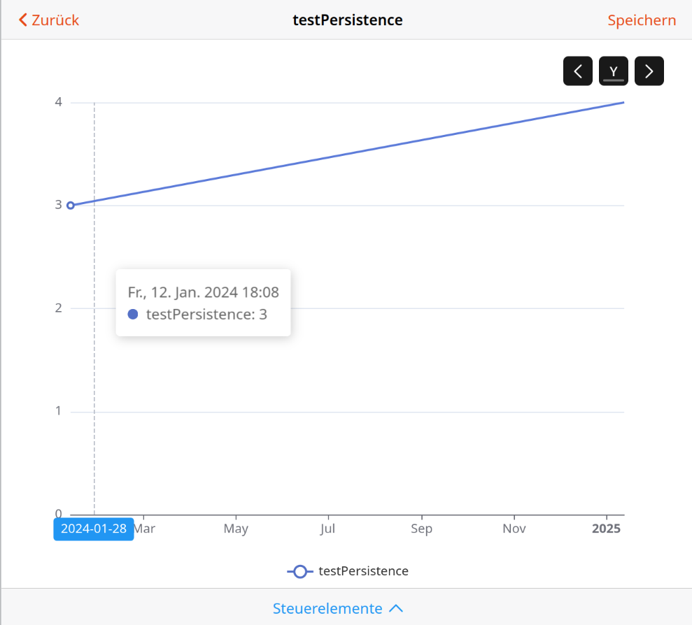

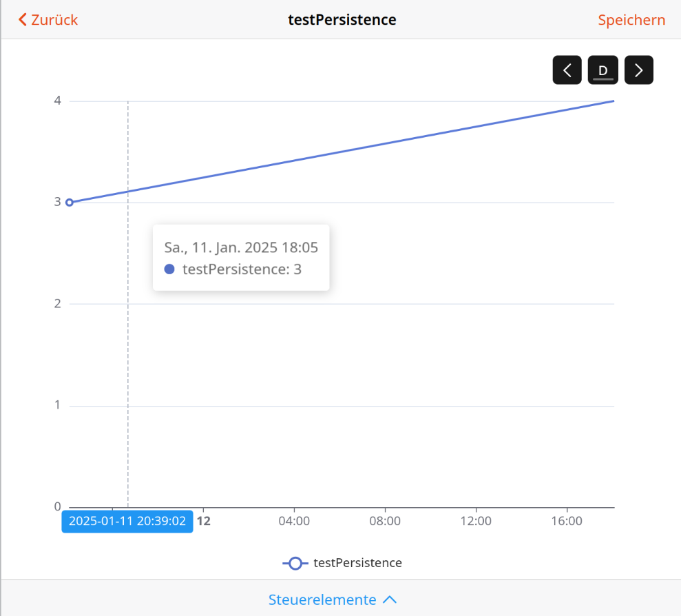

Unfortunately even if they are valid timestamps, openhab can’t properly deal with them. I run this script for a new item (which is configured for jdbc persistence):
test = items.getItem('testPersistence');
test.persistence.persist(time.toZDT().minusMinutes(2), '1', 'jdbc')
test.persistence.persist(time.toZDT().minusMinutes(1), '2', 'jdbc')
test.persistence.persist(time.toZDT(), '3', 'jdbc')
test.sendCommand(4)
Then I tried to make a chart with the analyzer:
So the timestamp seems to be interpreted as a very old value.
I experience the same problem @chaoshome, did you find a solution to it?
Unfortunately no.
