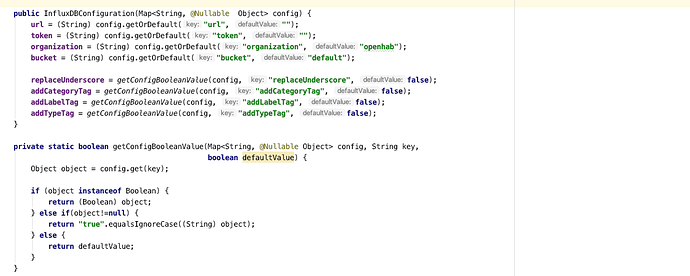

I’m looking at warnings from null analysis and I found some cases that are difficult to manage.
For example in the attached code where are fields are @NonNull
JDT is not capable to detect that Map.getOrDefault can’t return a null value and it gives a warning.
And if I remove the @Nullable from the map then the second method complains about the else if is dead code because can’t be true.
How do you proceed in these cases? Just put a @SuppressWarnings(“null”) is fine?
I suppose that I can introduce a getOrDefault method in my class to get ride of the warning, but it seems an antipattern for me to create more code to solve limitations of the static null analysis.
That’s what I do. I don’t like it, but I’m not aware of any other way to deal with it.

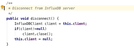

And it’s getting worse… If I have a field that is @Nullable
I can’t do that:
This solves the warning but it’s ugly to me, it’s the way to do?
Looks fine. But better style would be to chose a different name (e.g. dbClient, so you are sure not to confuse them). The local variable can also be final.
It’s annoying but the warning about fields is a totally valid one if you consider concurrency.
Imagine two threads call disconnect() at the same time.
Thread 1 evaluates client != null is true but then suspends before evaluating client.close().
Thread 2 then evaluates all of disconnect() and sets client to null at the end.
Thread 1 resumes and tries to evaluate client.close() but client is now null so you get a NullPointerException.
If I remember correctly the null checker will respect assert x != null if you have some local variable that is definitely not null but you are hitting some limitation of the checker.
Thanks to all.
I understand the concurrent use case.
But a lot of classes are not intended to be used concurrently and prior code can be safe due to its invariants. And the ones that support concurrent usage and have state, normally will need some synchronization logic to don’t corrupt internal state or break invariants. And you can easily get to the same situation because in these cases, null safety is only a little part of the photo.
An annotation to declare that the state can’t be concurrently updated will possibly help in these situations, but looking at the doc doesn’t seem to be available.
I will go for the local variable trick then, I don’t like to modify code only to make tools happy, but I understand the value of standardization.
Wearing my pedant’s hat I could make the argument that any use of a class that is not explicitly disallowed is implicitly allowed. So not making a class thread safe and NPE proof is a bug because how is the next person (or you in the future) who uses your code meant to know about your unenforced invariants. Ah… for a world were all java is annotated with JML and the behaviour of everything is perfectly defined…
Taking the hat off again, yeah it is kind of annoying. Not everything needs to be “perfect” and static analysis tends to be hard so tools are often over cautious.
But… unintended NPEs are a really common bug so is it not worth occasionally doing a little dance for the null checker to prevent lots of bugs that are easy to catch? :man_shrugging:

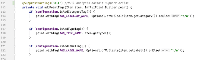

I have a new case that I don’t know how to solve (in a nice way)
Although I have the @SuppressWarnings(“all”) or (“null”) I get that compiler error:
Error:(114,4122) java: Null type mismatch (type annotations): required '@NonNull String' but this expression has type '@Nullable String'
Any ideas of how to solve it (without removing the orElse)
I have to say since we last talked I have become less of a fan of null checking in this project because I have noticed the implementation used is not just over conservative but seems to actually be pretty broken in some cases.
I guess @SuppressWarnings is not working because it is marked as an error, not a warning.
It looks like this error is because we are not using an annotated JDK it does not know Optional#orElse(@NonNull T) will allways return non null.
Unfortunately I think this would make any use of Optional#orElse(...) very messy (you would have to do a null check to prove to it you know it is not null).
It’s probably simpler to just do something like this:
if (configuration.isAddCategoryTag()) {
    @Nullable String tag = item.getCategory();
    if (tag == null) {
        tag = "N/A";
    point.withTag(TAG_CATEGORY_NAME, tag);
I suppose you could also try putting @NonNullByDefault({}) on the method and see if that does anything for a hacky fix.
