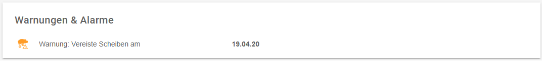

Sitemap:
    Frame label="Warnungen & Alarme" {
        Text item=SA_IN_IceWarning_ForecastDate label="Warnung: Vereiste Scheiben am [%1$td.%1$tm.%1$ty]" icon="weather_snow_ice_warning" visibility=[SA_IN_IceWarning_ForecastId == 1]
        Text item=SA_IN_IceWarning_ForecastDate label="Warnung: Ggf. vereiste Scheiben am [%1$td.%1$tm.%1$ty]" icon="weather_snow_ice_warning" visibility=[SA_IN_IceWarning_ForecastId == 2]

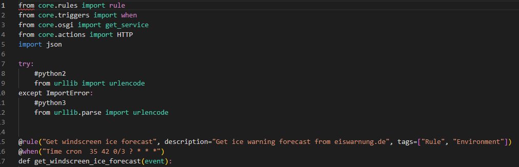

from core.rules import rule
from core.triggers import when
from core.osgi import get_service
from core.actions import HTTP
import json
try:
    #python2
    from urllib import urlencode
except ImportError:
    #python3
    from urllib.parse import urlencode
@rule("Get windscreen ice forecast", description="Get ice warning forecast from eiswarnung.de", tags=["Rule", "Environment"])
@when("Time cron  35 42 0/3 ? * * *")
def get_windscreen_ice_forecast(event):

do you also use it in OpenHAB3? Currently I have problems there that he complains about the “from”:
did you install all relevant things for python rules?
