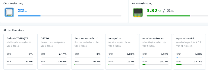

In the moment openhab it uses 1.6 GB RAM from 8 GB. All services in total use 42% RAM.
Total CPU use is 13% when the system start is done.
I would appreciate any hints on how to optimize my system.

There’s not a whole lot you can do here. As a Java application it will grab memory as it’s needed but generally never gives any back. You should see the RAM usage ramp up to a certain point and then level off. If it never levels off there is a memory leak and you OH will crash with an OOM exception at some point.
Running in a container is going to significantly increase the amount of memory so running on bare metal will reduce memory requirements, but that really isn’t an option on Synology.
For the CPU you’ll need to identify what services are actually using CPU to see if OH is even contributing significantly to the overall usage.
Then you’ll have to hook up a profiler and/or enable logging for Rule events to see which rules (if any) are taking the most amount of time to run. Once you identify those then you can look at optimizing the code.
But if you have over 50% RAM free and 87% CPU is idle, you don’t have a performance problem. It can be a fun problem to explore but overall you’ll be imposing a burden on future you to solve a problem that doesn’t actually exist. That’s not a great tradeoff.
