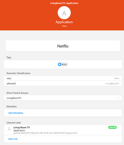

Hello again Rich,
Sorry I have to bother you again but I was trying to make the script work and Icant.
In JavaScrpti the TV ON/OFF and the sleep command works well, but the Application Change command to Netflix dosent. I been trying all possible combinations before posting again and I couldnt make it work. Added other options like Mute, Volume, etc and all work, but the Application Change dosent. Application Change works from the toggle in the Item.
The script in Rules DSL dosent work at all for me.
Im attaching some screenshots of the scripts and the Item and thing configurations.
I’m doing something wrong?
Thanks,
Pablo
I can’t really do anything with just the screen shot of the Item.
And for everything else except Items, the text from the Code tag is way more useful than a screen shot.
