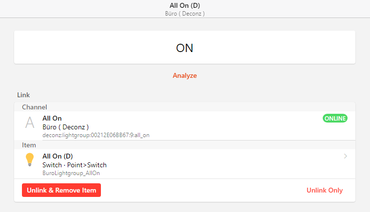

I have another issue with this Deconz Thing. The switch of this Phoscon Group in the Thing is not switchable, it behaves like a string.
Yes, a restart (probably disable/enable of the thing) should be enough.
The all_on and any_on channels are read-only. Deconz does not allow to set these, they are only status-reports.
To switch all light, you need to use the color channel (you should be able to link that to a switch).
got it, thanks Jan!
Re-attached the switch to the Color channel and this works of course. I could have come to this conclusion on my own :slight_smile:
