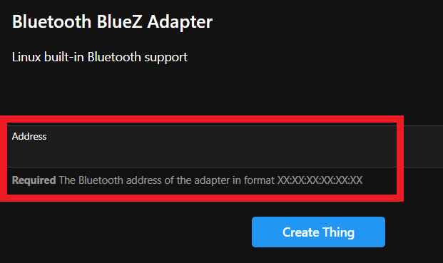

How to add adress Bluetooth BlueZ Adapter
Where can I get this address from?
I tried to find the address but it’s not correct. I would like some advice that I can find.
That looks like the Bluetooth MAC address. Try search for how to find blouetooth mac address for your OS.

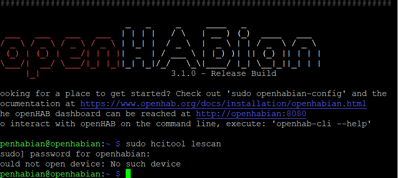

Am I using this command right?
hcitool dev is the correct command.
Why doesn’t the mac address show?
Here it does.

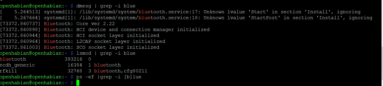

What is the output of:
dmesg | grep -i blue
example output:
[    8.040110] Bluetooth: Core ver 2.22
[    8.040262] Bluetooth: HCI device and connection manager initialized
[    8.040951] Bluetooth: HCI socket layer initialized
[    8.040977] Bluetooth: L2CAP socket layer initialized
[    8.041020] Bluetooth: SCO socket layer initialized
[    8.060161] Bluetooth: HCI UART driver ver 2.3
[    8.060191] Bluetooth: HCI UART protocol H4 registered
[    8.060357] Bluetooth: HCI UART protocol Three-wire (H5) registered
[    8.061847] Bluetooth: HCI UART protocol Broadcom registered
[    8.573682] Bluetooth: BNEP (Ethernet Emulation) ver 1.3
[    8.573694] Bluetooth: BNEP filters: protocol multicast
[    8.573710] Bluetooth: BNEP socket layer initialized
lsmod | grep -i blue
example output:
bluetooth             393216  24 hci_uart,bnep,btbcm
ecdh_generic           16384  2 bluetooth
rfkill                 32768  6 bluetooth,cfg80211
ps -ef |grep -i [b]lue
example output:
root       549     1  0 Sep16 ?        00:00:00 /usr/lib/bluetooth/bluetoothd
The last command shows nothing.
What is the output of following commands:
dpkg -l |grep -i blue
cat /etc/os-release
uname -a
cat /proc/cpuinfo  | tail -15
Best would be if you could copy paste the text output instead of taking screenshots as it is easier to read text than screenshots.
