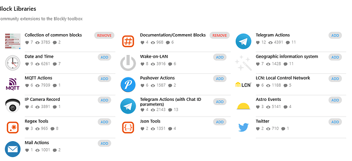

I try to add some blochy libraries to openHAB3.
In the manual it is sayd to be done via ‘settings’ → ‘automation’ → scroll down to blocky lybraries.
But under the automation tab I only have 3 options:
  • JSScripting
  • Groovy Scripting
  • JRuby Scripting
So is there an other way to download extra blocky lybraries?
These features have been added over time. You probably are not using a recent enough version. Which version of OH3 are you using?
I think the newest: 3.3.0 (windows 10)
It is under Settings → Addons → Automation

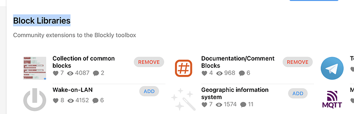

I’ve just installed and tested some block libraries and now I want to remove them. How can I do this?
I cannot see any ‘Remove’ or ‘Delete’ button in the openHAB menu.

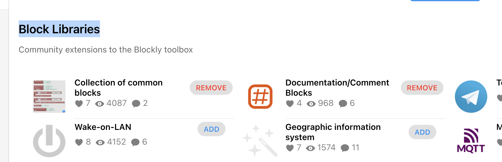

Go to Settings->Automation, scroll down to “Block Libraries” and click on remove to remove the block library:

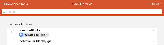

or click on Developer-Tools → Block Libraries, click on "Select! on the upper right corner, click the checkbox of the library you want to remove
and then “remove” on the lower left corner.
Thanks, but I didn’t install my block library this way. I used “Developer Tools > Block Libraries > Add”, so your suggestion won’t work for me.
Did you try out the second option I described above? I just added a lib via “Developer Tools > Block Libraries > Add” and then removed it again without a problem with the second option I described above.
Yes, but I don’t have any “Select” checkbox next to the library name. Believe me, I tried to find this checkbox for a very long time, but it is simply not there. I even looked at the raw HTML code with the same result.

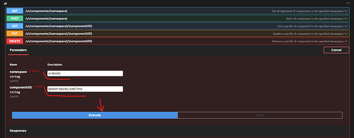

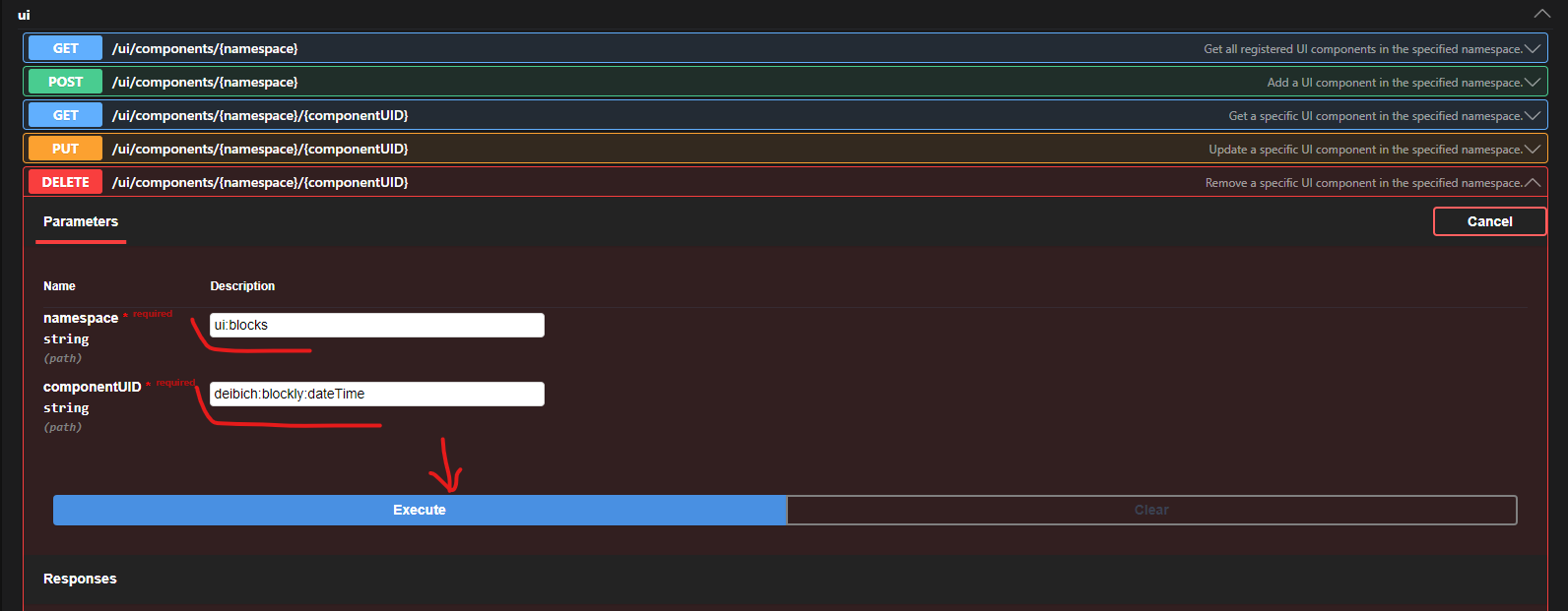

However I’ve just found the solution to my problem.
I used this method: “Developer tools > API Explorer > ui > DELETE”
