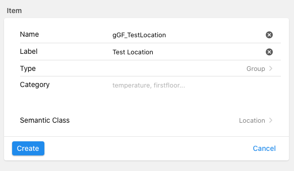

When I was defining my model, I noticed that the current lists for Category and Semantic Class seemed to miss a few itens I would like to define (e.g. Den, Dining Room, Entrance, Veranda, etc.). How can I add to those lists, so my location model better reflect my dwellings?
Also, can one of you gentle souls advice on the relation between Category and Semantic Class, if any?
They seem to point towards the same idea, so why do we have two different fields for the same idea?

I think Category is mainly used for Icons.
Simple answer, you can‘t.
The semantic modell is hardcoded in the sources.
So only chance is to file an issue on github with a feature request for your additions.
But reading what you think is missing, there is not much chance to get this accepted, e.g. Dining Room, this is just a room, unlike a Kitchen, which was build to be a Kitchen. So there is a difference between „simple“ rooms and „special purpose“ rooms.
Similar to Veranda, isn‘t this just another name for a Terrace ?
Regarding Semantic class, there is a PR in progress. It should cover your needs. We all hope it will be merged soon.

There isn’t. Category is a hold over from OH 2 and is used to define the icon that gets used by default on a sitemap. It appears to also be used as the icon used in the list of Items. It has nothing to do with the semantic model.

Does it make sense to rename it in the UI? I’m also rather confused by it.
How can we set the category from the *.item files? or is it set from the *.thing files?
or is this all handled with the tags and depending on if a tag is matching a Semantic Class the semantic class will be set?
I do not remember but know it is documented in the OH2 Items documentation because I use it. I just looked and, in fact, the refer to it as Icons.
It’s the icon field. Items | openHAB
