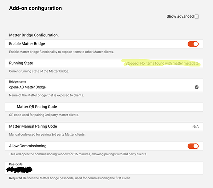

Hello, I would like to use my OpenHAB as a Matterbridge to integrate my Velux or Homematic devices into Google Home, for example.
For testing purposes, I first ran the Matter client in OpenHAB and successfully integrated the IKEA DIRIGEA Bridge there.
However, I’m a bit confused about configuring OpenHAB as a Matterbridge.
If I understand correctly, the option is only enabled when at least one device has received the “matter” metadata.
Screenshot 2025-04-22 20.30.07
But how and where exactly do I specify this? Does anyone have instructions or an example?

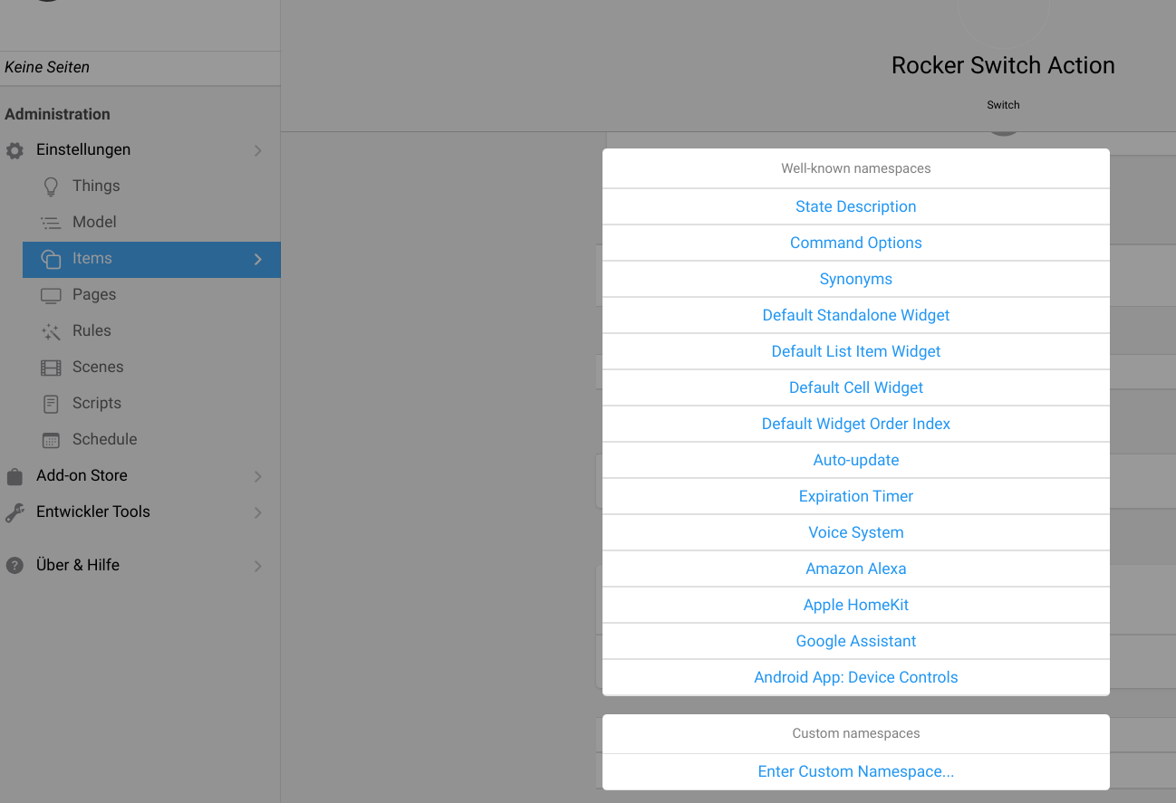

Is it here “Items”? What next?

Yes, custom namespace with ‘matter’. Then fill in the value. Below is for a light.
The possible values are documented here.
value: OnOffLight
config: {}
that works. Thanks
FYI - I think the plan is to get Matter added to the Well-known namespaces list, just isn’t done quite yet.
