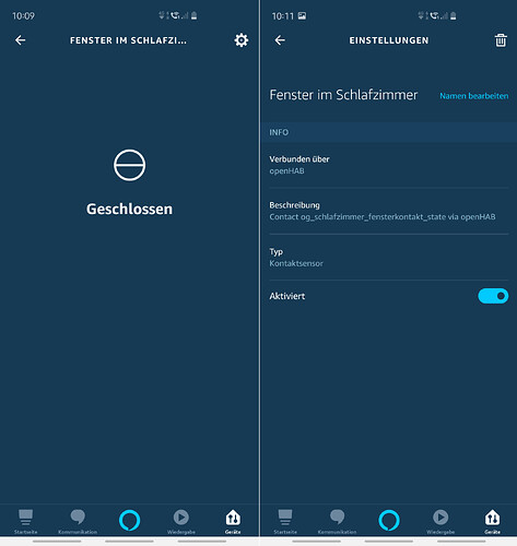

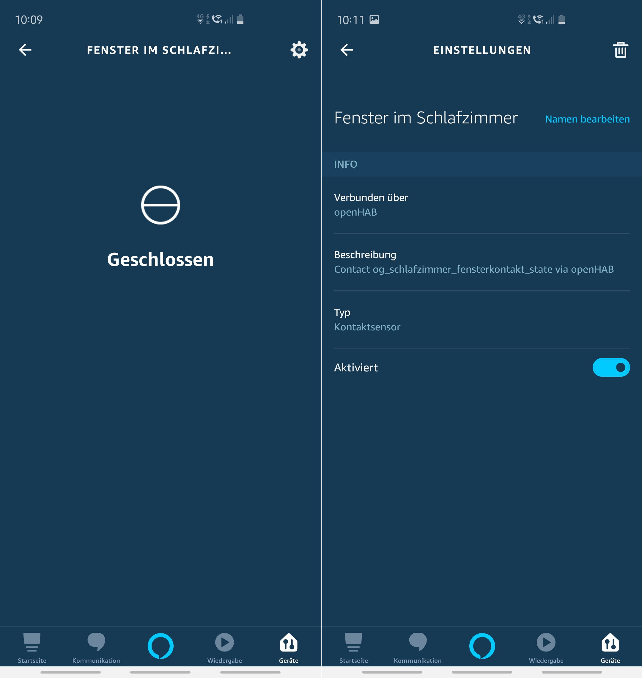

As it is sometimes - you wait months for something until you create a workaround and a week later Alexa detects my “ContactSensor” item in a search for new devices.
Even though it’s not updated in the “Openhab Alexa V3 skill” documentation - not even in the Alexa skill API documentation from Amazon - that ContactSensor is supported in Germany - it can be found by Alexa App and shows the status ‘open’ vs. ‘closed’. Alexa also responds to the question: “Is my bedroom window open?” with “Bedroom window is closed” (without the phrase “I’ll check this”)
The additional “Switch” items are not necessary anymore. Just add alexa=“ContactSensor.detectionState” to your “Contact” item. For groups of windows I created an additional “Contact” item which references the group, instead of adding the Alexa tag in every window contact.
My new items file looks like this:
// group for complete MAX! system
Group gMax "Max! system"
// groups for rooms
Group gMaxBedroom "Bedroom" (gMax)
// groups for specific aspects
Group:Contact:OR(OPEN,CLOSED) gMaxWindow "Windows contacts" <window> (gMax)
// house
Contact house_windowContact_stateControl "Windows in my house" {alexa="ContactSensor.detectionState" [itemSensor="gMaxWindow"]}
// bedroom
Contact og_bedroom_windowContact_state "Bedroom window" <window> (gMaxbedroom, gMaxWindow) {channel="mqtt:topic:myMQTTBroker:og_bedroom_windowContact:STATE", alexa="ContactSensor.detectionState"}
