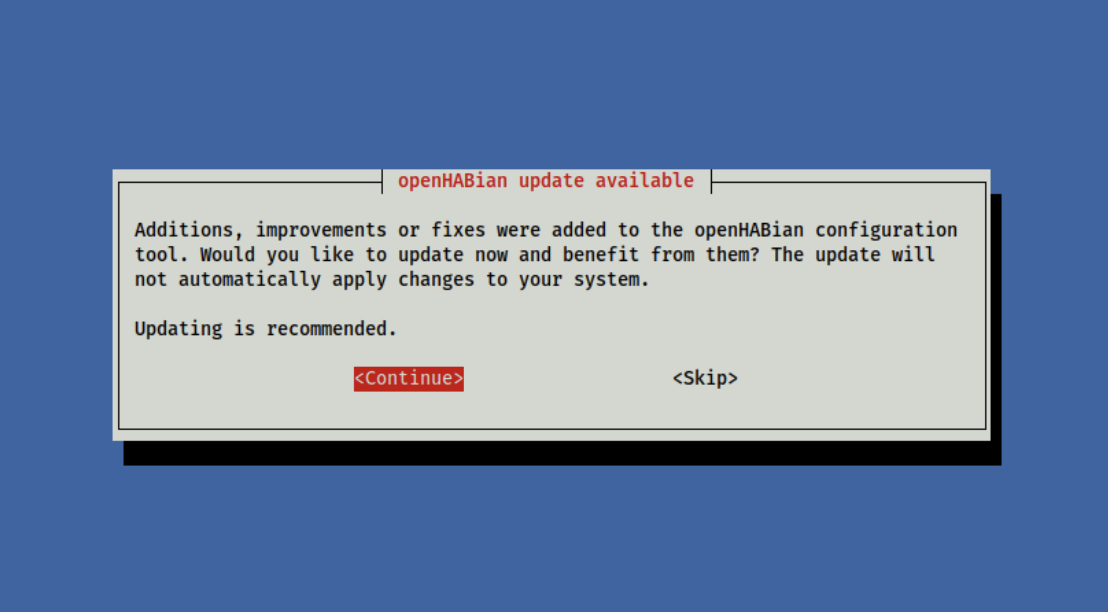

openHABian isn’t the operating system. It’s the scripts that configure the operating system. When you run openhabian-config, unless it’s an older version, it should ask if you want to upgrade it. Make sure to upgrade it.
