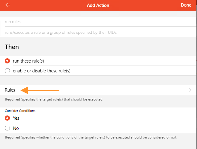

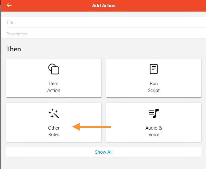

Ah I understand. Furthermore to the solutions from Rich you can create a single rule with the actions you got in your script and then run this particular rule from your other rules. As „Then“ run rule and select it.
Should be the same like calling the script in others rules.
There is no list to select scripts in OH 3.4.4. How do I select my script written in Main UI to be run by a rule?
Yes there is.
