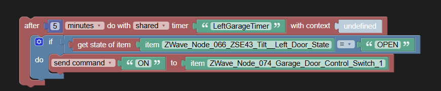

I have a Blockly timer that closes the garage door after it has been open for 5 minutes, unless someone closes it before that.
I’d like to add a way to cancel the timer anytime before it closes the door.
My Blockly looks like this
The rule code is

I’ve created a Cancel Timer Switch.
The question is where should the Cancel Timer Block go?

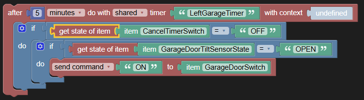

Maybe you don’t need to cancel the timer, just make the action conditional.
Then put an expiration timer on the cancel switch of about 5 minutes.
