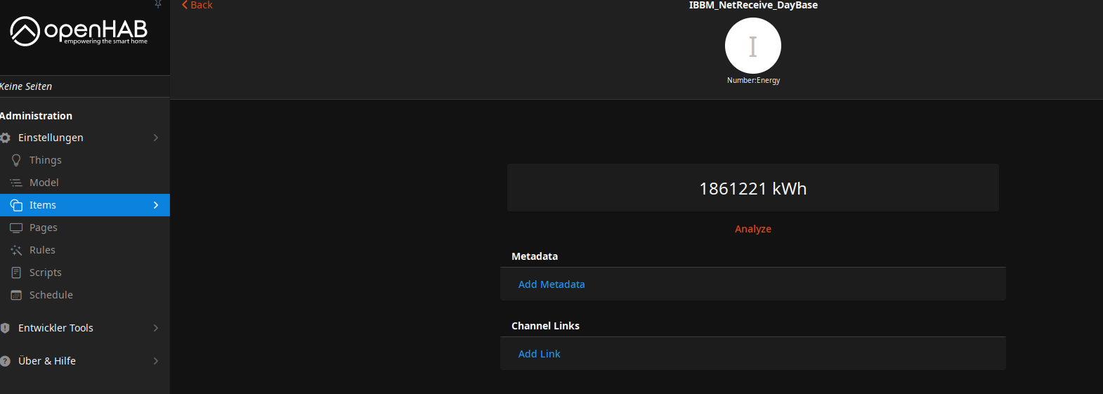

I am preparing on my Raspberry 4 (Openhabian 3.4.5) the update from 3.4.5 to 4.x and have unfortunately set some of the number items to “kWh” instead of “Wh” in the *.items files. As a result, some values were calculated incorrectly.
But now I have corrected the unit - nevertheless the unit remains in “kWh”.

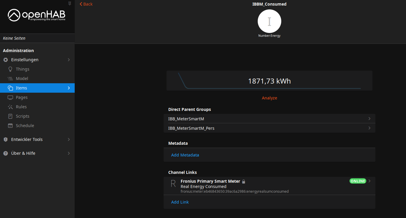

For now, I am back to my previously created backup. Here you can see that the channel “Real Energy Consumed” does not provide a unit in the “smart meter” although the channels in the “inverter” have units:
It is as I have said:
The channel of the item “IBBM_Consumed” does not have a unit. I accidentally assigned the wrong unit in my configuration (kWh) and I can’t get back (Wh).

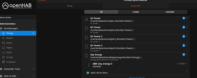

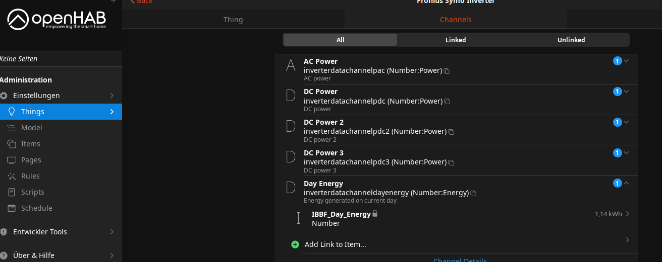

For example here is a channel from the inverter with a delivered unit
