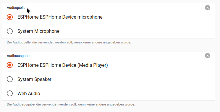

I got this branch compiled and running,
  1. The binding is detecting the media player correctly.
  2. Seams that the audio source is detected. At least I can choose it under the config “Audio” as a source. But I can’t choose a sink. Looks like it is not detected. If necessary, I can provide logs.
By default, the device does not response to anything. Also the configured wakeup word (in the device - hey jarvis) does not work.

Some more positive news: I’ve managed to get the first complete pipeline up and running. That doesn’t mean it works perfectly—just that it runs in principle.
  • The microphone can essentially be used right away with the esphome pull request mentioned above. (Including my tiny fixed regarding the base url)
  • There was a bug in Whisper that caused an infinite loop during periods of silence; this is being fixed here.
  • The biggest issue is audio output. OpenHAB doesn’t natively support the FLAC format, which is crucial for ESPHome. I temporary solved this by using the speach service directly ans ask for FLAC as the output format. Complicating matters further, quite a few things are hard-coded in OpenHAB—for instance, the “UrlAudioStream” class, where MP3 is hard-coded for some reason. Additionally, the device’s FLAC media player wasn’t recognized because the codec isn’t supported. To get it working anyway, I temporarily intercepted FLAC and effectively swapped it for “MP3.” This doesn’t mean MP3 actually works; it just allows me to use the UrlAudioStream.
  • On the device side, there is still an issue with an annoying background tone, which stems from the device’s electronics. I also managed to crash the device several times, so it will likely take a few more firmware versions before it runs stably.
Below, you can see the Python code I used to initialize and start the pipeline. I chose Python because I like using it for rapid prototyping.
