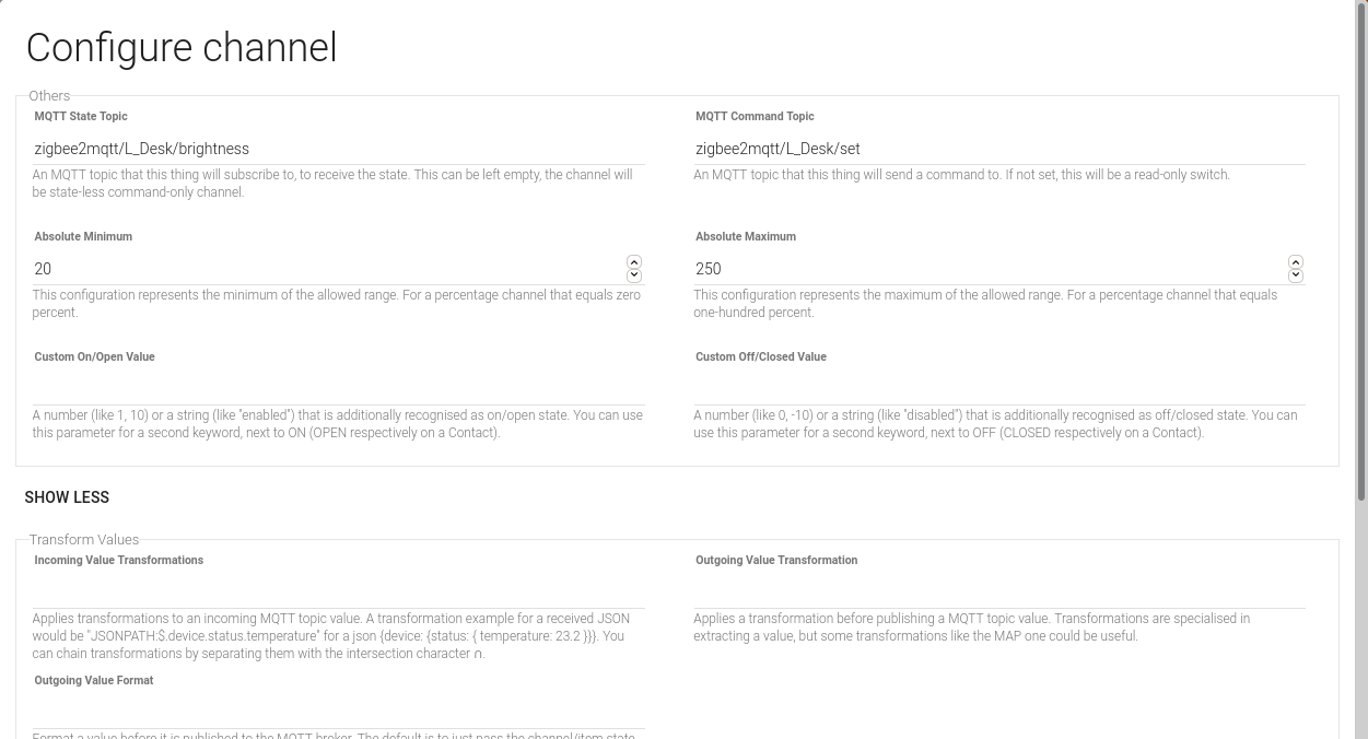

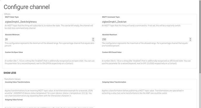

I’ve a small test setup for openHAB 2.5.9 and want to configure the brightness for a Hue lightblub.
I can change the brightness with:
mosquitto_pub -t zigbee2mqtt/L_Desk/set -m '{"brightness":"100"}'
But what is the correct setup in Paper UI for this?
I assume I need to tell openHAB to send it as ‘{“brightness”:“100”}’, but how?
To make this easier, I would recommend to add:
experimental:
output: attribute
to your zigbee2mqtt configuration.yaml
This means you’d only need to send 100
(or any number) to zigbee2mqtt/L_Desk/set/brightness
(note the change in command topic; your state topic remains the same).

Wow, many thanks Works now.
I already use output: attribute
but was not aware of this topic. Is it possible to browse/discover the available topics?
