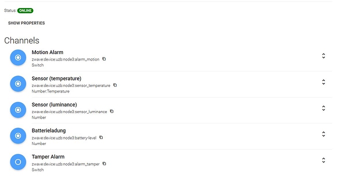

As the name states it is a scene controller.
You need to link a number itemtype to the scene_numberchannel, then catch the button presses in a rule and do stuff with it.
