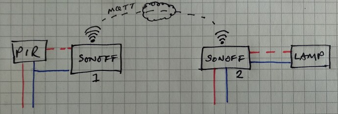

A few weeks down the line into my home renovations and I got my Sonoffs and tried, with the advice given and additional research, to figure out a way of utilising them in a standard PIR + Lamp system. I tried to work out how to use the Tasmota-flashed Sonoff to statist the following requirements.
  1. When the PIR detects motion a message is sent. (To be aware if a potential intruder or welcome visitor is present)
  2. Permit me to turn on the Lamp remotely whatever the state of the PIR (a problem, because when the PIR detects no motion it’s relay controlling switched live (L’) is in the off position, i.e. it’s turned the light off as intended).
I could not see how to use the GPIOs on a single Sonoff to meet these requirements.
I’ve ended up with this design decoupling the PIR and Lamp functionality. They talk to each other over MQTT.
Can anyone think of a better (e.g. improving elegance, simplicity, speed, cost, stability, etc) solution that gives full independent control of the lights?
Physical environment.
I have 4 external areas to my property. Each area is covered by one Lamp activated automatically by its own PIR. All the Lamp and PIR cabling is terminated together into a DIN-railed electrical board in the loft. The broker is Mosquitto with OpenHabian on a RPi, all latest versions.
