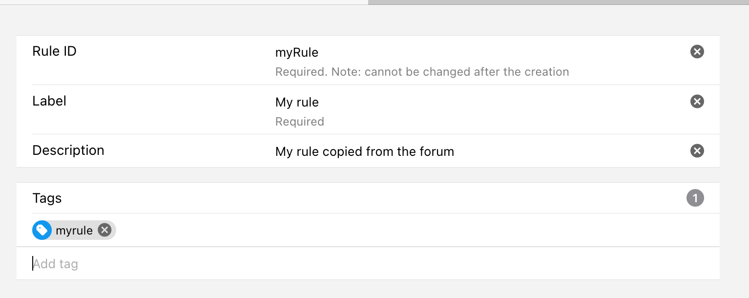

- Change the Rule ID to something meaningful. Create a human friendly Label and add a Description and tags as desired.
