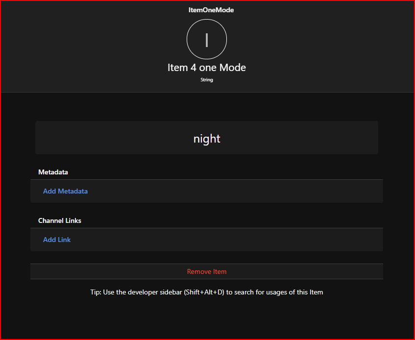

You can create an item with the type String and fill it and query it in rules and let things happen accordingly. Please remember that the check (==) is case sensitive.
DSL rule example:
if (ItemOneMode.state == 'night') {
  logInfo("OneMode","Turn lights off")
} else if(ItemOneMode.state == 'vacation'){
  logInfo("OneMode","do other tings")

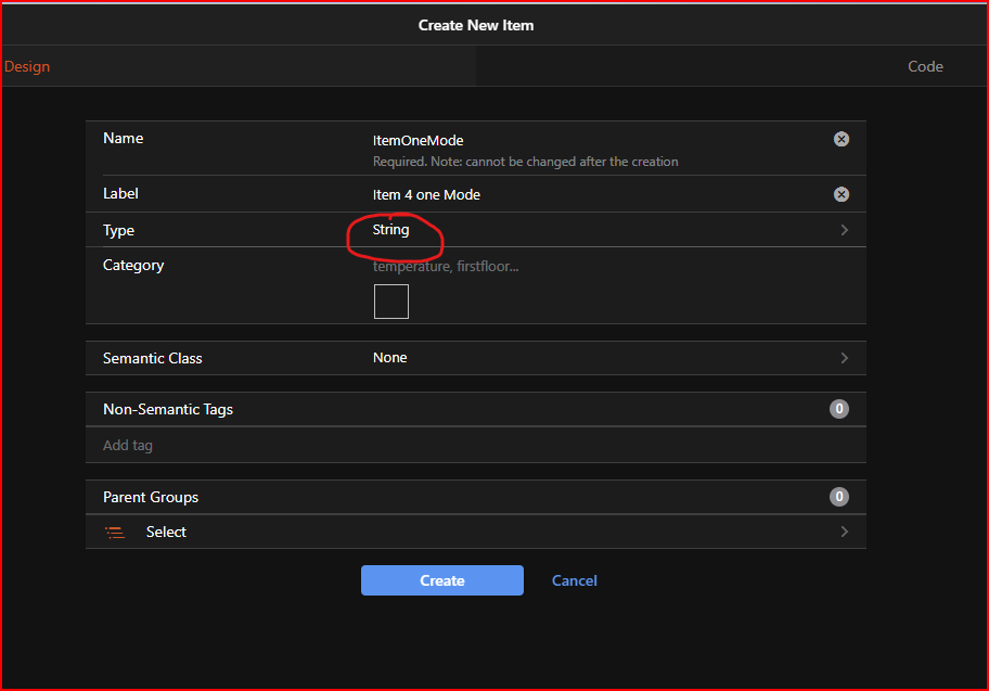

  1. create string item

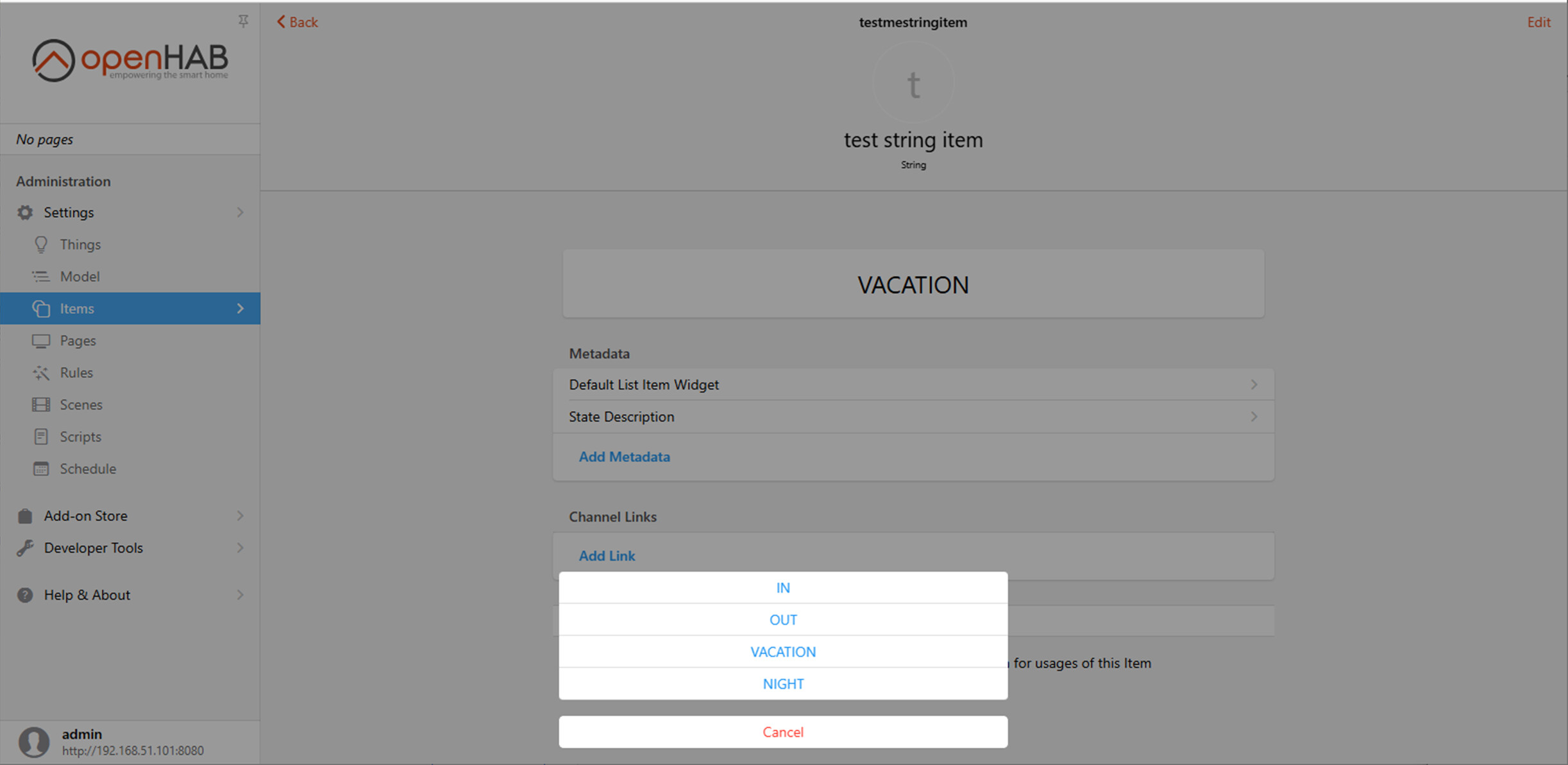

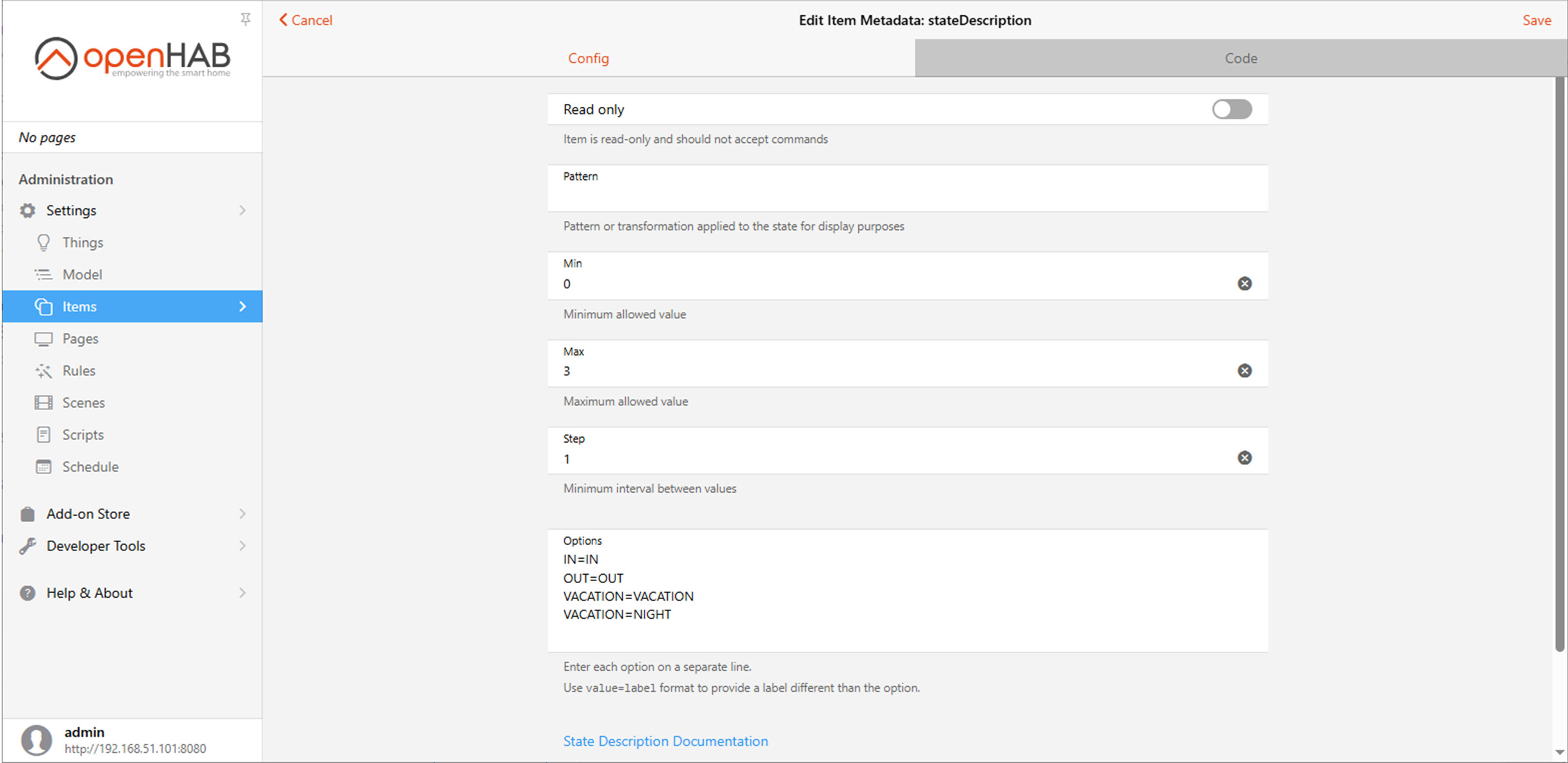

As many folks have said you can create a string item then use metadata to add state descriptions something like this
value: " "
  options: IN=IN,OUT=OUT,VACATION=VACATION,VACATION=NIGHT
  step: "1"
  min: "0"
  max: "3"

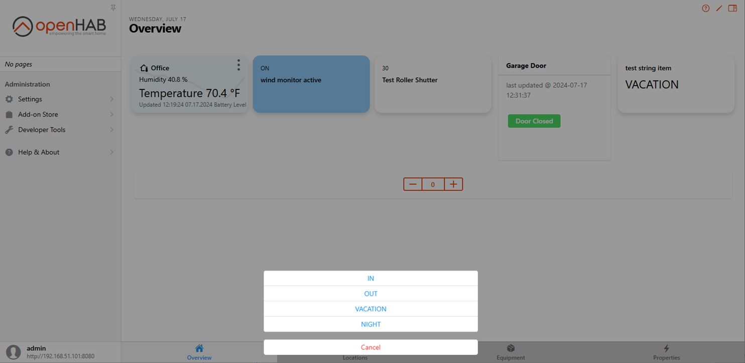

you can even then create a Default list widget to populate the string item

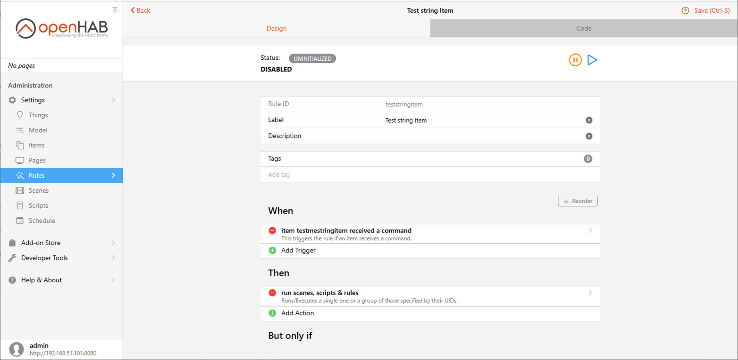

and rules then when item state changes like
`configuration: {}
triggers:
  - id: "1"
    configuration:
      itemName: testmestringitem
    type: core.ItemCommandTrigger
conditions: []
actions:
  - id: "2"
    configuration: {}
    type: core.RunRuleAction``
to trigger what ever if condition you want to happen when that string item is populated with your selected value

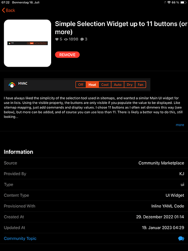

This widget is also very helpful

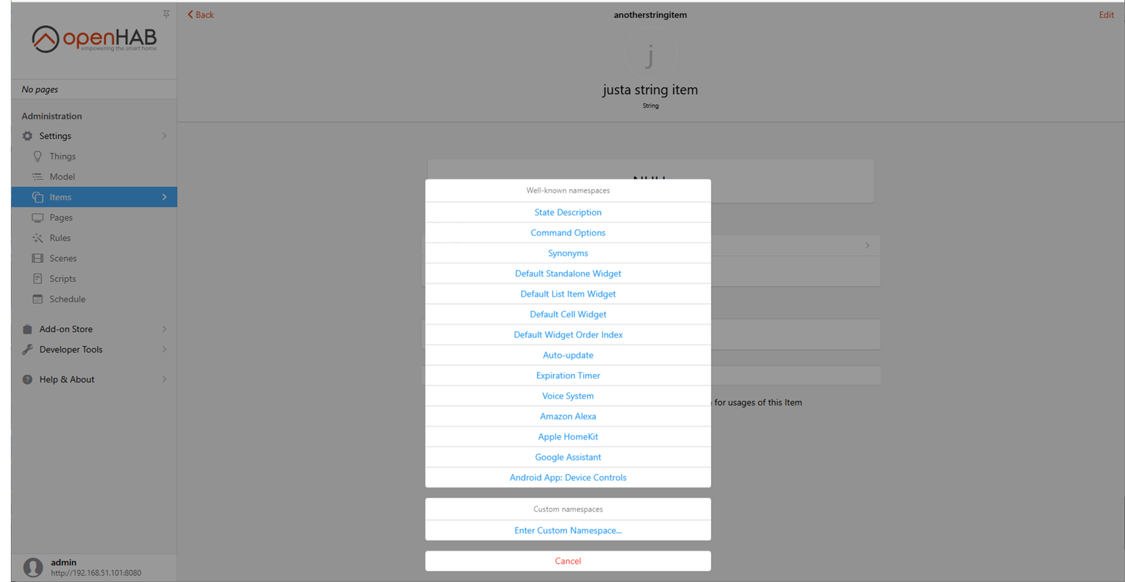

Just a question: What I do not fully understand how you “create a Default list widget”. Do you mean you make your own widget? If so, could you please send me the full code of such widget?

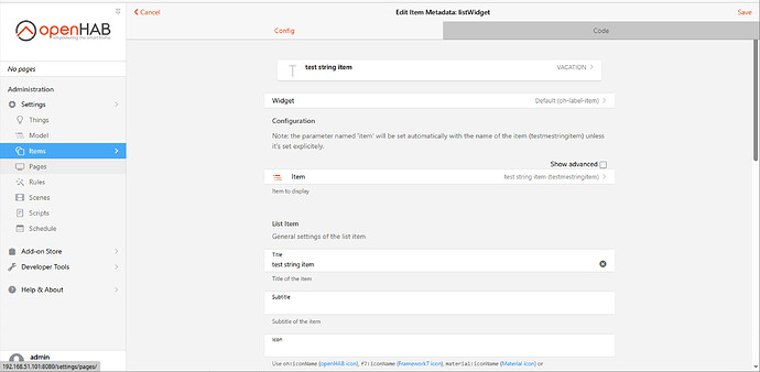

when you click on add metadata you see options for
various default widget types you click on the kind you want and fill in the info as you need and it becomes a default widget for that item.

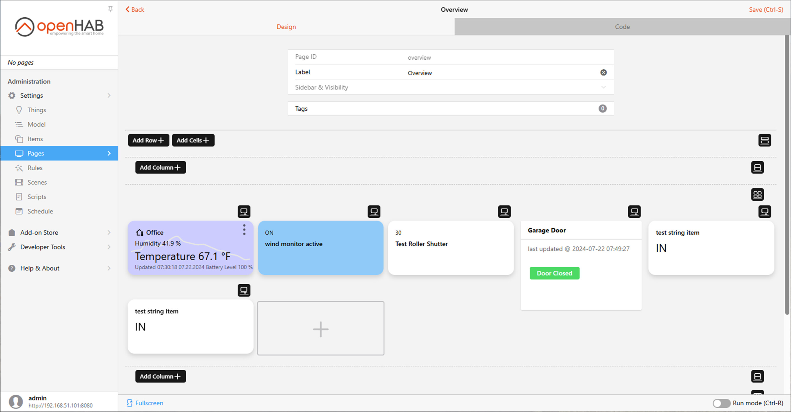

and afterwards to place the widget on a page? Which of the standard library you select (cell, slider, etc..) to see the new string item?
after you create your default widget you go to page and add from model then place check mark in the non semantic box and select your item click pick 1 and it will appear on the page in the selected place you chose
Hope this helps.
Thanks for the explination - that worked perfectly!!
