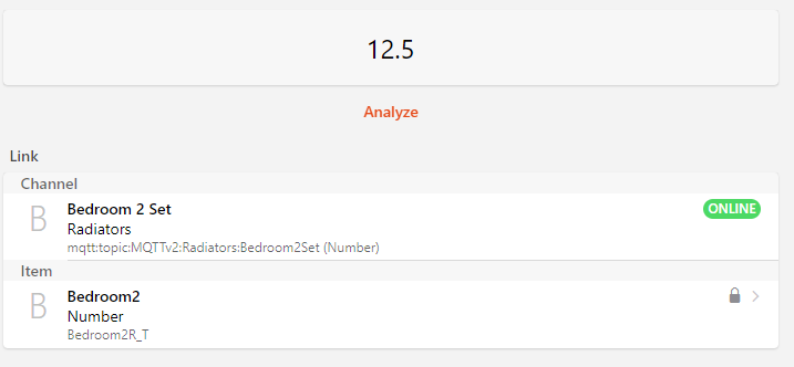

But it dos not work correctly if you use a channel fro temp defined as mqtt:number (as it should be in theory as it is a number what you receive and not a string). Only works if you define it as mqtt:string.
Well mine work as Numbers
