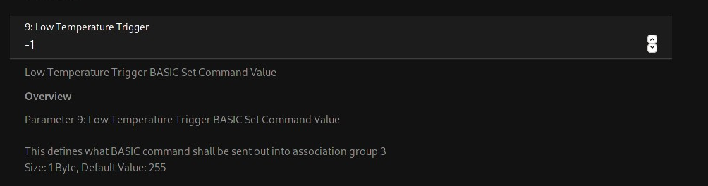

Hi,I am actually in the process of correcting the Mold Detector database entry. In the process, I noticed one thing that I don’t know exactly how to deal with:
According to the documentation, parameter 4 is 2 bytes in size and has a value range of 0 - 65535. It is therefore unsigned. However, OpenHAB apparently makes a 2 byte signed value out of the value. The value is -22336.

Hm, that’s not so nice. Could it work to define the field size as 2 bytes instead of just 1 (for the paramer 9 as example) ?

Parameter 9 ( 8 bit): 11111111 (=255, but displayed as -1)
Parameter 9 (16 bit): 00000000 11111111 (=255 and also displayed as such)
