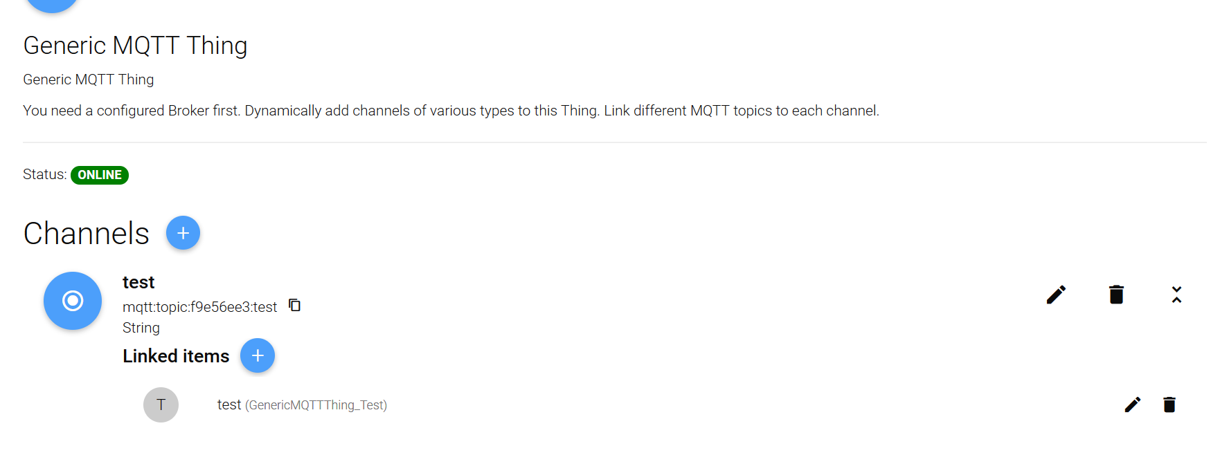

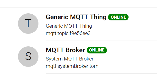

Configuration looks good. The MQTT Broker and Generic Thing are online in PaperUI?
Can you add a simple String channel/item for debugging and then use mosquitto_pub -t your_topic -m test_message?
Hi David,
thanks for the quick reply!
Both the Broker thing as well as the Generic MQTT thing show online in PaperUI.

Hi all,
I do have the same issue, even with 2.5.0#1571. I do run a blank expert installation with only mqtt binding installed and try to get a text value updated to the sitemap.
From debug log I see that openhab gets the state updates
2019-04-16 13:25:57.908 [DEBUG] [o.client.mqttv3.internal.ClientState] - jarvis2: received bytes count=1
2019-04-16 13:25:57.909 [DEBUG] [o.client.mqttv3.internal.ClientState] - jarvis2: received bytes count=98
2019-04-16 13:25:57.909 [DEBUG] [mqttv3.internal.wire.MqttInputStream] - null: Automatic Reconnect Successful: PUBLISH qos:0 retained:false dup:false topic:"Hugo2C/Roon/Arbeitszimmer (HQ)/now_playing/one_line/line1" payload:[hex:4261636b206f6e207468652044616e636520466c utf8:"Back on the Dance Fl" length:39]
2019-04-16 13:25:57.909 [DEBUG] [o.client.mqttv3.internal.ClientState] - jarvis2: received key=0 message=PUBLISH qos:0 retained:false dup:false topic:"Hugo2C/Roon/Arbeitszimmer (HQ)/now_playing/one_line/line1" payload:[hex:4261636b206f6e207468652044616e636520466c utf8:"Back on the Dance Fl" length:39]
2019-04-16 13:25:57.909 [DEBUG] [client.mqttv3.internal.CommsCallback] - jarvis2: new msg avail, notify workAvailable
2019-04-16 13:25:57.910 [DEBUG] [client.mqttv3.internal.CommsReceiver] - jarvis2: network read message
2019-04-16 13:25:57.910 [DEBUG] [client.mqttv3.internal.CommsCallback] - jarvis2: call messageArrived key=0 topic=Hugo2C/Roon/Arbeitszimmer (HQ)/now_playing/one_line/line1
2019-04-16 13:25:57.910 [DEBUG] [client.mqttv3.internal.CommsCallback] - jarvis2: notify spaceAvailable
2019-04-16 13:25:57.910 [DEBUG] [client.mqttv3.internal.CommsCallback] - jarvis2: wait for workAvailable
however the attached item is not updated.
Both thing and broker are online (whole config done via paper ui)
.. yet the item remains empty
Appreciate any ideas that could help me on this.
Might also be worth mentioning that adding a sonoff/tasmota device does work well without any trouble - at least for the power state.
Tom
OK it seems that either the whitespace or the bracers are a problem for the binding. Removing those in the topics and it’s working like a charm.
