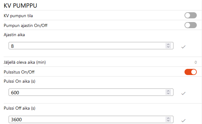

How to decrease input box for Input List Item
I would like to reduce the width of an input box for an Input List Item. The screen copy below shows that the input boxes are too wide and I haven’t figured out how to reduce the width. Could this be done in the YAML code?
