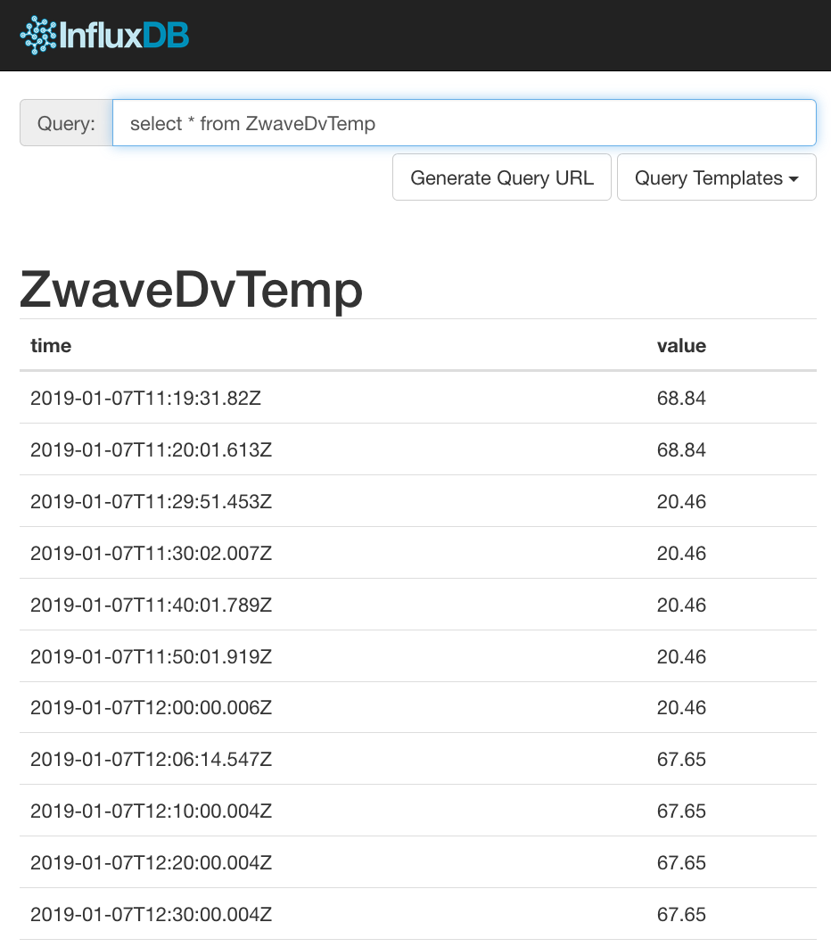

Choose one item and you can list the entries of an item table with
> SELECT * FROM item_table
In the Admin UI you get an output with time in the “normal” date format:
Running this command on the command line gives you an output with time in the UNIX timestamp format in milliseconds:
