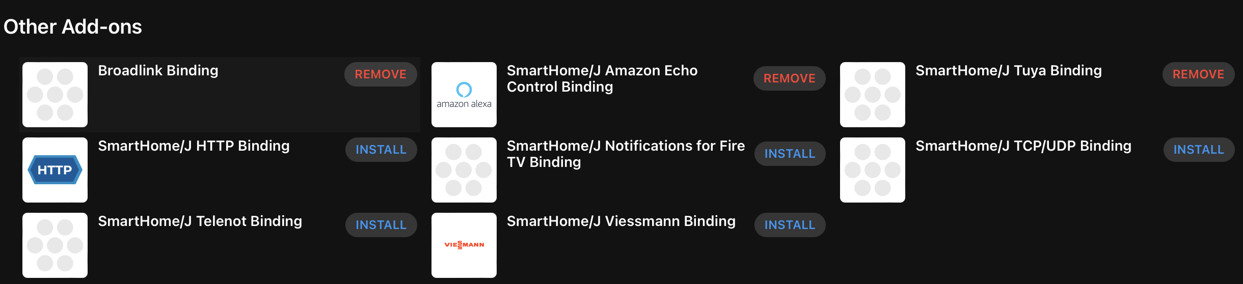

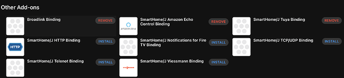

Thanks, this put me on the right track. The binding was not being added to the addons list. Reading up the code it seems it checks for the existence of OH-INF/addons/addons.xml
This was a fix I made, but I still used the bundle:install and bundle:remove to add and remove the binding.
It seems that adding the correct jar file in the add-ons folder does an additional step, which is missing from bundle:install: adding the binding to the addonInfoRegistry.
TLDR;
When making a binding, ensure you have a OH-INF/addons/adddons.xml file and put the jar of your binding in the addons folder and do not use bundle:install.
