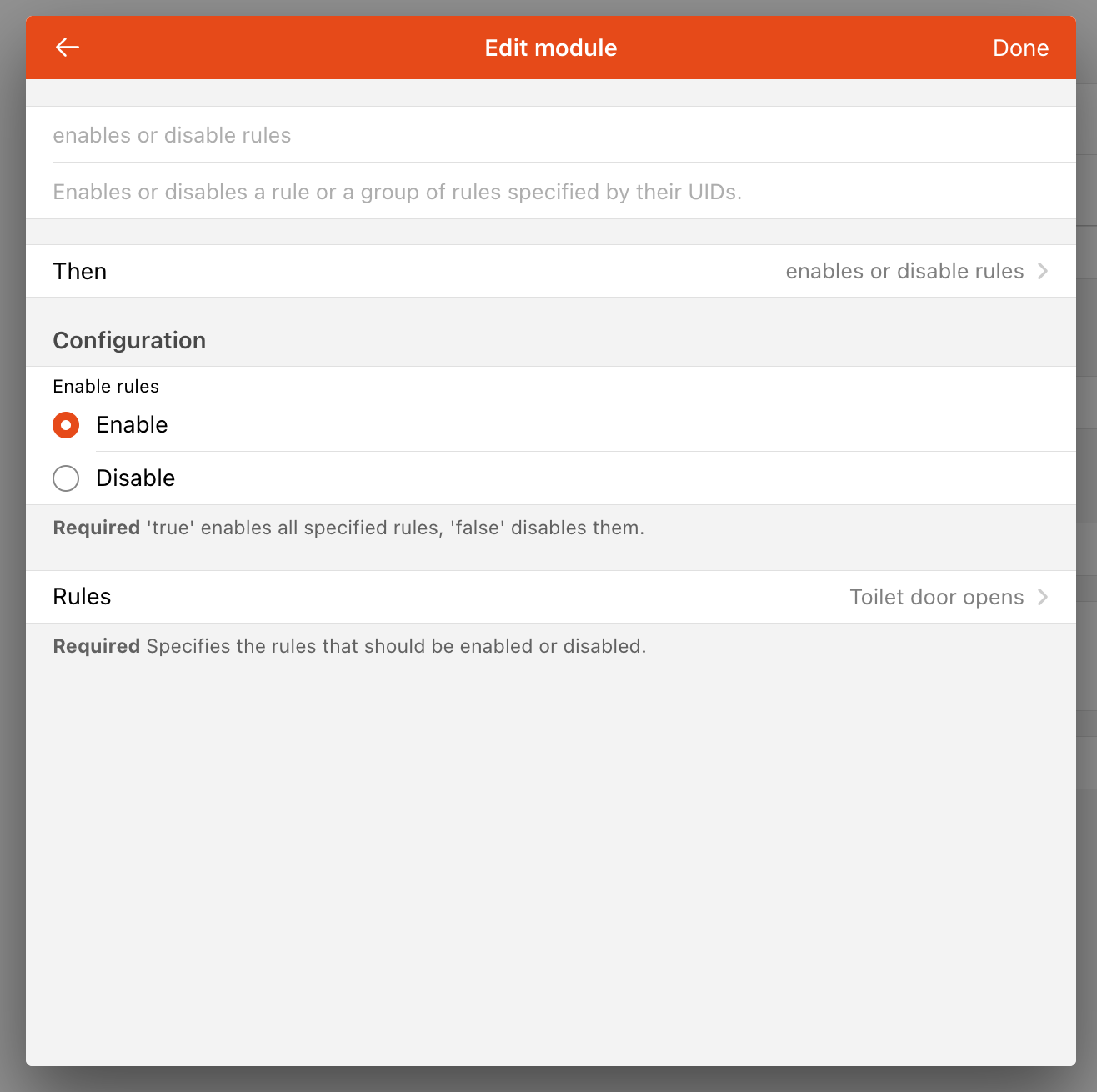

This is how I currently enable/disable rules:
The above shows the rule that enables another rule. Correspondingly, there is another rule that disables it.

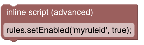

From 4.x on, you can use jsscripting (graalvm) which automatically provides the rules-variable and then you can use the script-block to basically call that:
rules.setEnabled(‘myruleid’, true);

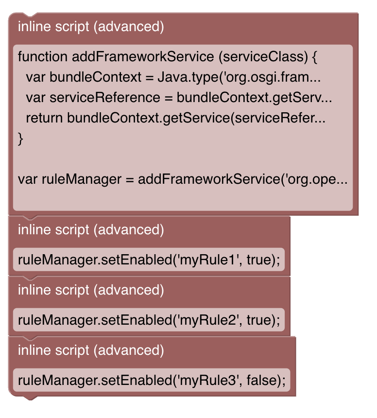

with the current Nashorn support underneath it would be also possible but it is more complicated. It requires the “ruleManager” which is not automatically provided only in the case you use this block:
which adds the following code
function addFrameworkService (serviceClass) {
  var bundleContext = Java.type('org.osgi.framework.FrameworkUtil').getBundle(scriptExtension.class).getBundleContext();
  var serviceReference = bundleContext.getServiceReference(serviceClass);
  return bundleContext.getService(serviceReference);
var ruleManager = addFrameworkService('org.openhab.core.automation.RuleManager');
ruleManager.setEnabled(‘1_filter_map_reduce_blockly’, true);
but it would be pretty ugly to only add that block which does nothing (in fact it generates an exception as it tries to execute that isn’t thee) only to have access to the ruleManager.
Instead, what you can do is to add that whole code to a seperate script block and the enable/disable as many rules as you like:

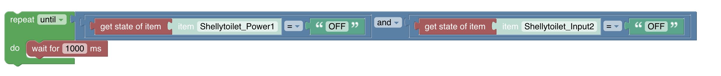

But I’m having second thoughts about moving various rules (i.e. rules that are only needed under certain circumstances) into Blockly scripts. Those thoughts don’t concern functionality but rather efficiency (and, if you wish, code aesthetics). Looking at the script below, I wonder how resource intensive this loop is when it checks the state of two items every second.
I assume that the loop that is built into the core of OH3 and which is checking for events that trigger rules is running at a much higher frequency, so checking every second is probably rather slow. So depending on how the two sloops relate to each other, I may even be saving resources compare to doing the same using two rules, but I have no clue, really.
I just have a feeling that this could be done in a more elegant way, e.g. if events could be “pushed” into the script, as it were, instead of it constantly checking.
So, to ask a question that may be relevant to also for other users: What would be some rules of thumb when implementing an event-based “trigger” in a Blockly script, i.e. a loop that waits for an event/ change of state?
The first rule is, of course: don’t check the state more often than necessary for the purpose at hand. But what else should one consider?
For example, I suppose there is no difference between the loop above and the following one (using until instead of while?
You should not use a loop but rather use triggers (see Rules - Basic | openHAB) to what for a change and then react on it.
Never use a loop with a wait …

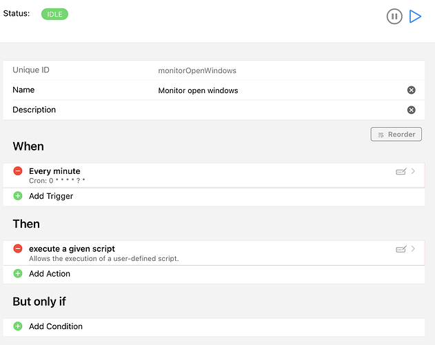

Sure, most of the rules have triggers, here is the config screen of a blockly rule
and see Rules Blockly - Before Using | openHAB

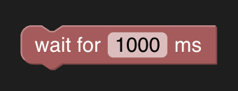

The “benefit” is that you must not wait in a rule - rules must not implement blocking behaviour but should finish as quickly possible.
If by “wait”, you mean this:
I understand that this is costly, which is why I asked:
If this is the same as the delay() function on Arduino, then I also understand that we want to avoid this because it blocks the entire thread (or whatever the equivalent to the main Arduino loop is here).
