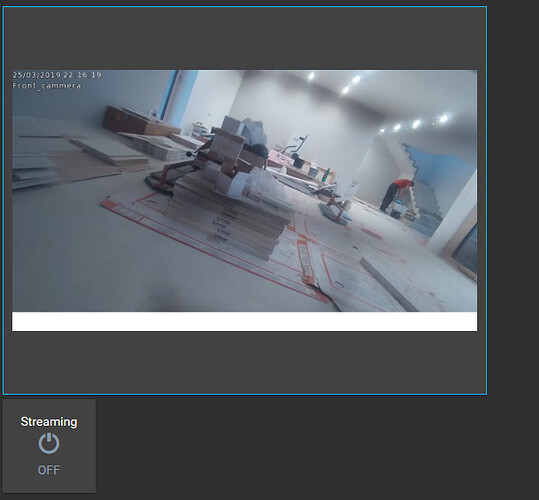

Hello All,
first of all I’d like to thank you for pointing me for this solution. I want to share solution I “create” which might find someone usefull especially regarding to high CPU usage.
Eventhough it is not issue in my solution (my HPE microserver can handle the streaming with no issue) I believe it is wasting of resources when 30% of CPU is used when nobody is watching current stream.
Solution: turn on streaming on demand.
  1. Configure ffmpeg as outlined in this post
  2. Create dummy switch for turning on the streaming - Dummy/Virtual item without a binding
  3. Create simple script for running the streaming from cammera and save it i.e. in /etc/openhab2/scripts/streaming_on.sh
!#/bin/bash
timeout 60 ffmpeg -rtsp_transport tcp -i 'rtsp://rstp_cam_rstp_stream' http://127.0.0.1:8090/camera_stream.ffm
  1. Create simple rule like:
rule "Streaming on"
			Item dummy_switch changed from OFF to ON
			executeCommandLine("/etc/openhab2/scripts/streaming_on.sh")
  1. Assing the dummy switch into HABPannel dashboard to turn on streaming on demand.
  2. Enjoy the result
PS1: the streaming will be available for 60seconds
PS2: saving the PID will help us also to turn off the streaming on deman.
Hopefully will find it out helpfull.

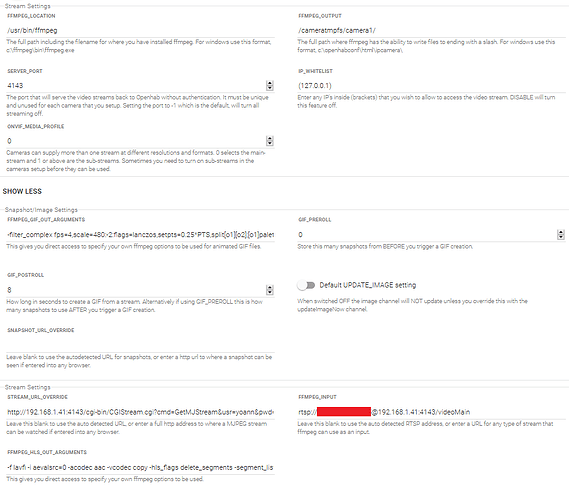

Try the latest ipcamera binding, I put a bit of code in that need testing to look for bugs but it is working for me if you only open it once. Ability to open the stream on multiple devices are the same time will be looked at over the next few days. If you leave the normal stream source field empty, it will now uses rtsp and ffmpeg to create the mjpeg.
@rkrisi
If the camera does not have bugs in the onvif support it should work and even get auto found by the binding now. If the camera breaches onvif requirements are does not report a snapshot url it can still be used by setting it up manually as a HTTPONLY thing type.
@z4nD4R
Thanks for sharing your method, really good to have multiple ways to choose from and in the forum for people to find. The binding can now create the stream on demand without the user needing to push a button, if the UI is open and needing the stream the CPU load is there creating the stream. To disable it like your method if the UI is left open then you would need to use a string that a button can clear or fill that is used in the Video item. However it is far easier to just close the UI and the binding stops.
I’m working with Ip camera Binding now and so far I have couple of troubles :slight_smile: first of all I kinda don’t get MJPEG (even it is foscam camera - supplier informed me that mjped is no longer supported - looks like true for as I’m no able to turn the mjpeg type stream via CGI command). Will in this case the binding perform coversion for me? ( I have setup the FFMPEG input and output).
Second issue is the zoom motion detection looks like not working at all, any suggestion?

Next version of the binding you will be able to do it with any thing type.
Until then you could set the camera up a second time as httponly, or you could just use the snapshots.mjpeg feature Outlined in the readme.
Sorry, I wrote it wrongly without commas, the second issue is the features like zoom, motion detection, enable/disable motion detection, pan, tilt and infra LED control aren’t working.
The issue is my Foscam is not supporting mjpeg (as I wrote above) and I’d love to use RTSP > MJPEG conversion on the fly when the UI is opened.
I will try to use suggested method with snapshots.mjpeg feature.
Y
It would be a good idea to test if your camera supports the api by entering in the URLs into any browser. And contact Foscam support as it may be as simple as ticking a box to enable cgi/api but as I don’t own Foscam I do not know.
