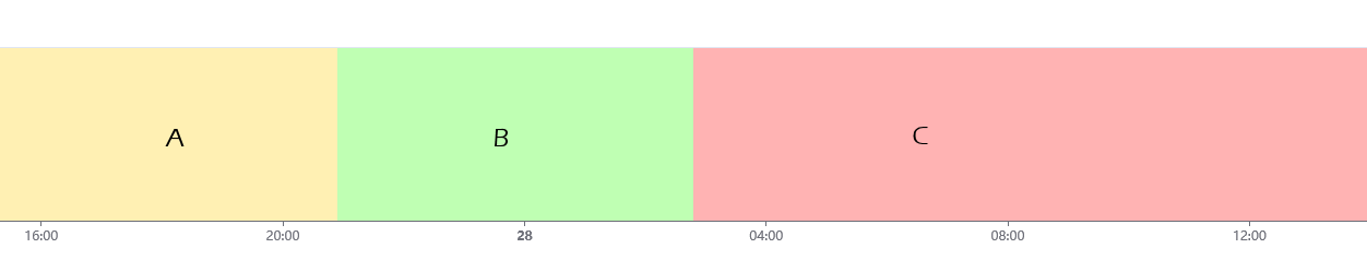

I would imagine it could be rectangular areas of colors that all have the same “height” but a different color depending on the name of the period.
Something like this for instance:
Is this already possible?
As far as I know you cannot chart Strings.
To achieve something like that the best approach I can think of is to use a switch Item. You can toggle the Switch when the time period changes. Then you can get a color shaded area when the Switch is ON and the lack of the shaded area when it’s OFF.
Yes, but that’ll only cover two possible values where I have at least three values here.
I’ll try to figure something out.
Convert them to numerical values 0
