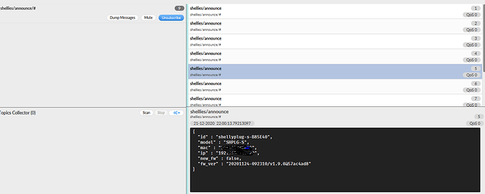

I Publish via MQTT FX:
shellies/command
payload: announce
all the shellies respond :
Can I evaluate this number of JSON responds too?
Not sure I understand what’s going on here: is every device publishing a message to exactly the same topic, at the same time? What is that topic? shellies/announce/#?
I think they do.
/# is a wildcard in MQTT FX to get all responds under this topic.
i hope i´m right
So what topic is each individual device actually pushing a message to? Is there an extra level under shellies/announce/?
No there is no level under this topic.
I think this is to check which shelly devices is online at the network. Like a call in the room and everybody who hear it answer who he is.
