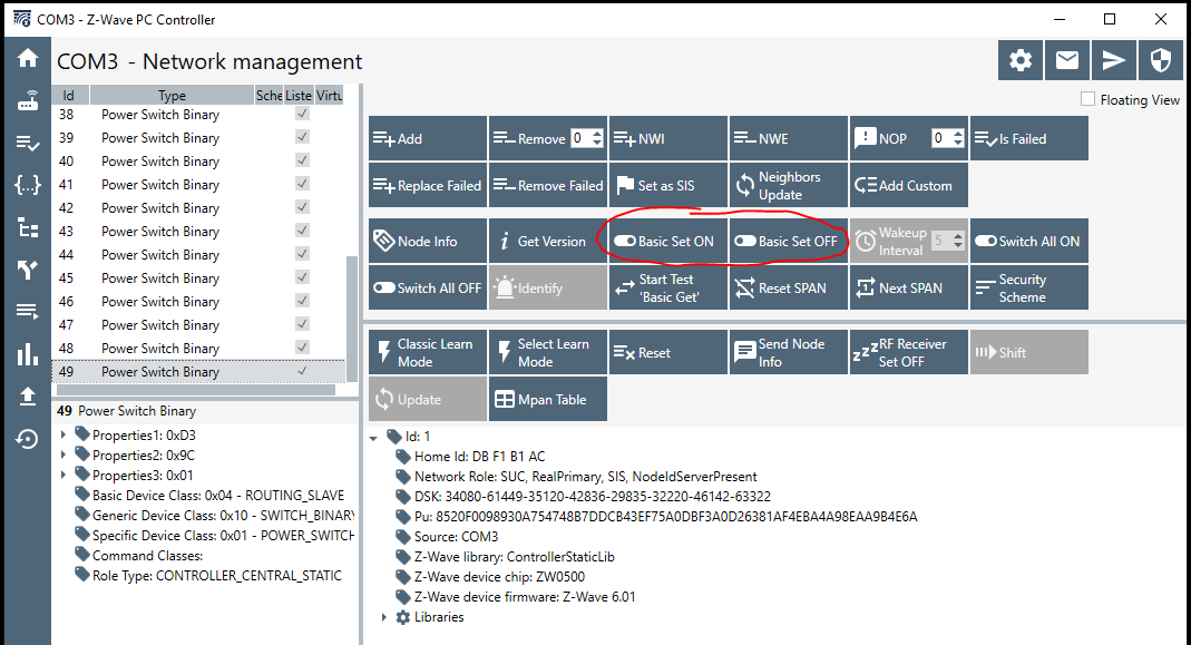

I did plug the Z-Wave Controller on my PC and using “Zwave PC Controler 5”, I can easily switch on/off the Fibaro Wall Plug corresponding to a specific node.
But I would like to find how to make it blinking instead. Indeed, I have to be in front of the Wall Plug to see that it goes On/Off or to switch all of them on/off a couple of time which not great for the devices plugged on them (NAS, Router, PC, Modem, Boiler, TV, Pump, Airco…).? Or I have to unplug all the devices in the house first :frowning:

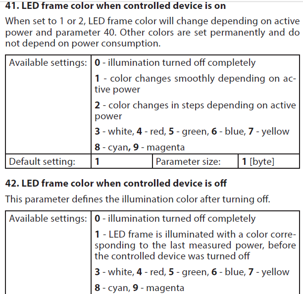

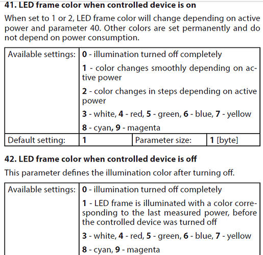

If supported by your devices and by PC Controller:
  1. Set all devices to ‘white’ (change configuration parameter 41 and 42 to 3).
  2. Set devices not yet identified to ‘red’ (4) one by one in order to identify the device you are looking at.
  3. Go to to next unidentified device.
  4. If all devices are identified: go to step 5, otherwise go to step 1.
  5. Reset colour of all devices.
FGWPB-111:

To swith on/off is easy because it’s out-of-the-box with PC Controller (it’s a “button” available on the selected node).

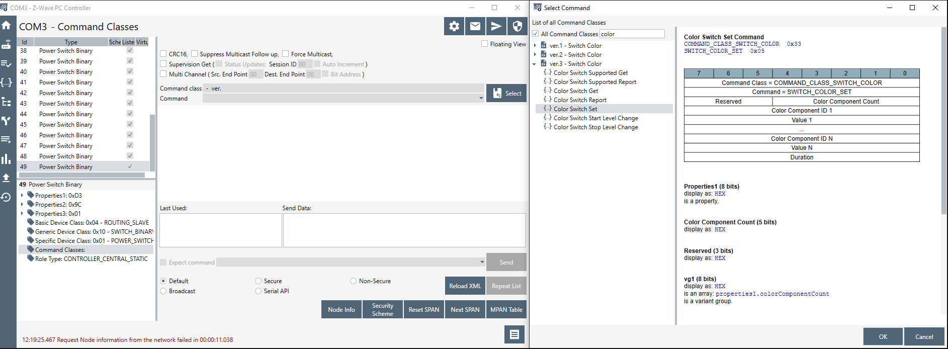

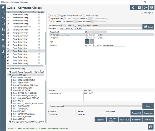

I understand that it must be done via the “Command Class”, but I don’t know what to send exactly… I found within PC Controler how to list all commands available:
Then, I tried to figure out how to use such Command.

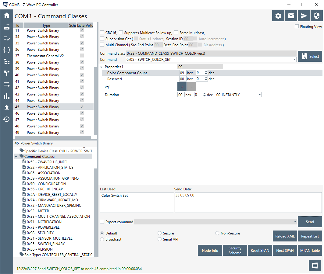

I was initially expecting PC Controller to set the property Color of the node 45 to Magneta (09) with the command WITCH_COLOR_SET… But it didn’t work… (I did identify the node 45 by switching it on/off first :slight_smile: ).
I was howerver not sure it was really the command to be used, based on the description from the manual of PC Controler (here under) and bacause it was not listed in the “Command Classes” of the node 45 (screenshot above)…

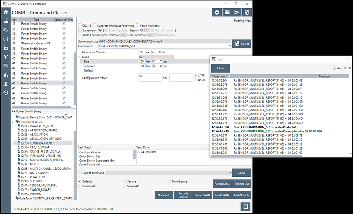

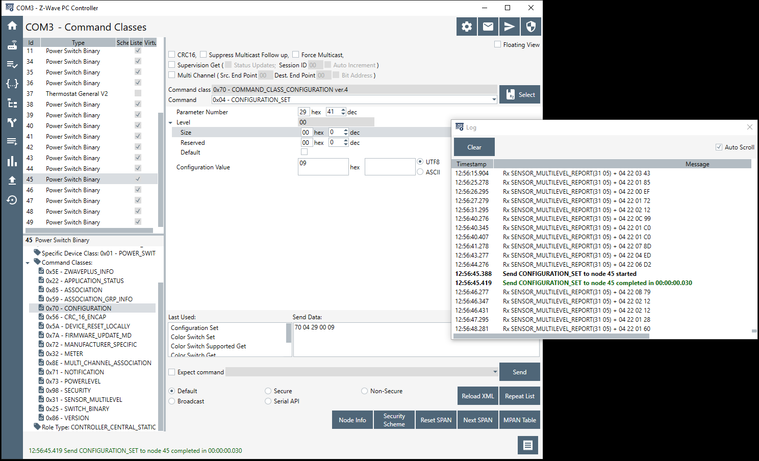

So, I tried next the CONFIGURATION command class, with the parameter 41 (no idea how to find the rigth value… stupid idea: maybe the id of the paragraph from the doc provided above ??? ) and a configuration value of 09… withouh more success ..
I guess I am not far from the solution… But not yet there either :frowning:

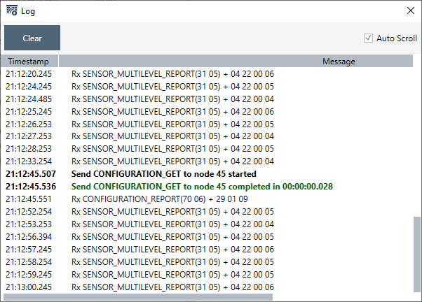

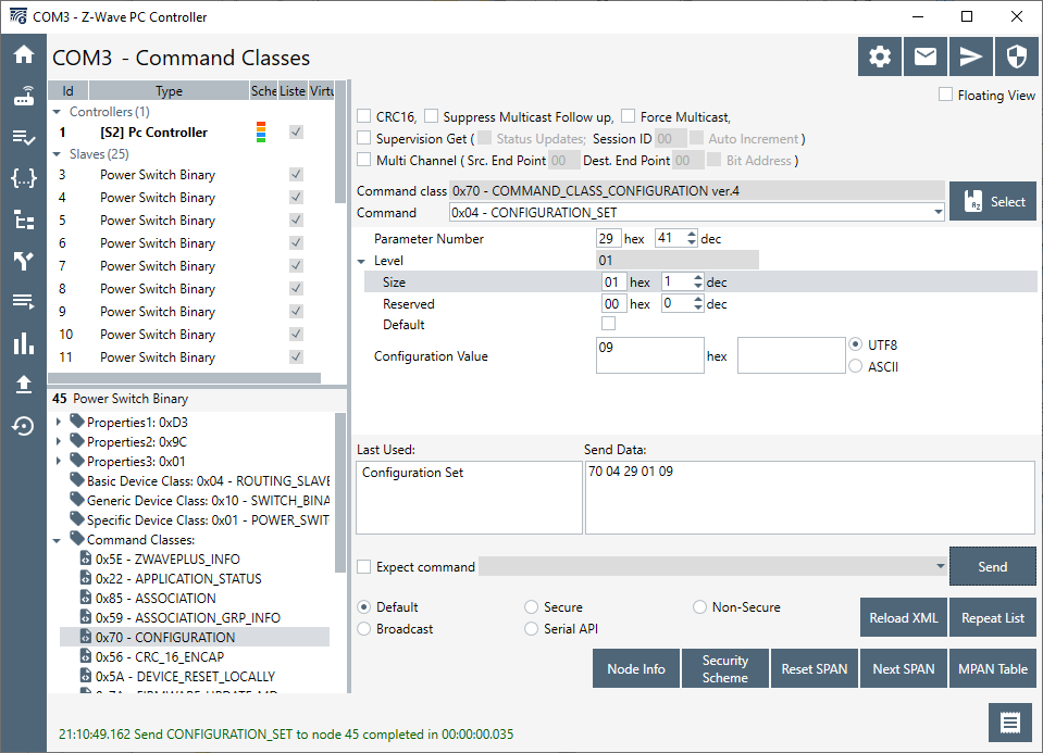

‘Configuration Command Class’ is the right class. Set Size to 1. Set the configuration. Then use ‘CONFIGURATION_GET’ to check the result.

BIG THX to you Ap15e !! It works with size = 1 !!!
I can confirm both with a CONFIGURATION_GET… and visually, as there is a nice Magenta in front of me :blush:
