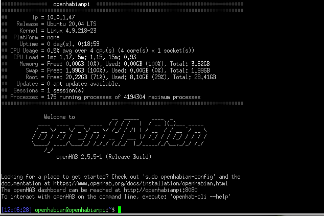

Took a bit for everything to install but OH with Ubuntu desktop is up and running.
Hehe it says free memory is 0, and used is 0 as well :slight_smile:

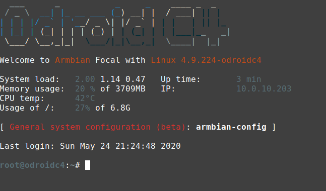

BTW. Updated Armbian, now also with (slightly improved) stock kernel.
Download + burn to eMMC + boot + create user + openhab web prompt in around 3m.
Now both images are present - stock and mainline 5.6.y. All images - also stock from Hardkernel or just about anyone - are immature on the hardware (kernel) level at this moment … Armbian come without insecure Debian scripts replacements, has no spyware & provides clean build process.
